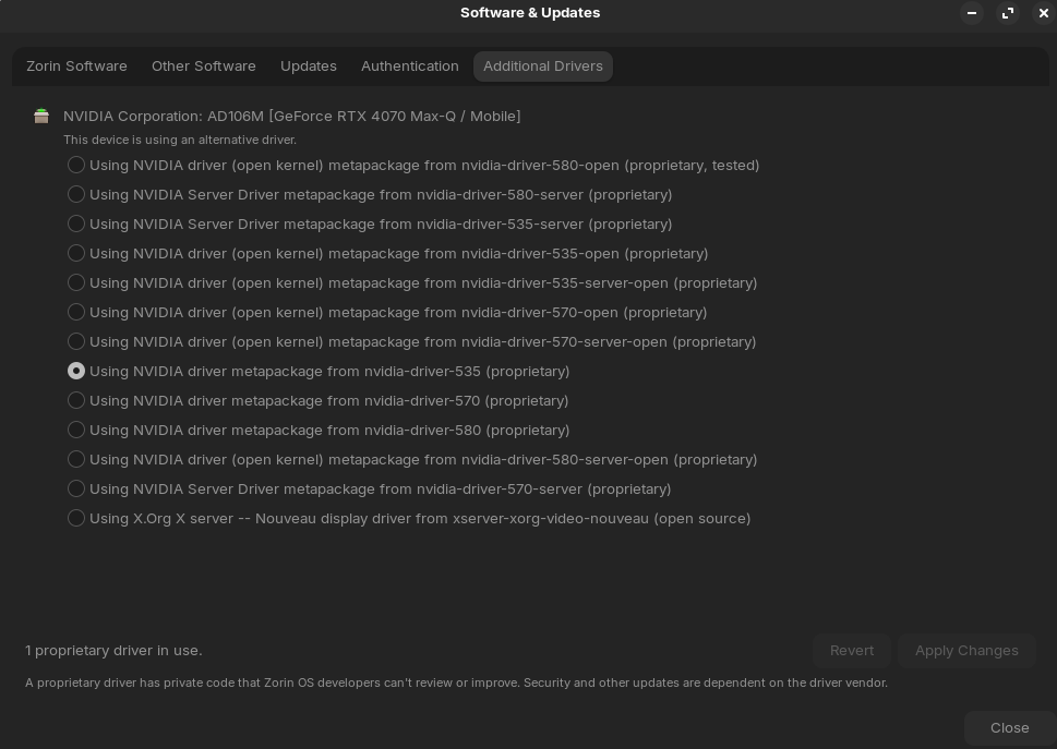

I followed the Activate NVIDIA Graphics Card article. At installation i checked the "Install third-party software for graphics and Wi-Fi hardware and additional media formats" box. At first the "X.Org X server -- Nouveau display driver from xserver-xorg-video-nouveau (open source)" was in use. I did the updates and first tried to download the "NVIDIA driver metapackage from nvidia-driver-580 (proprietary)" but i was prompted with an error. Then i tried installing the "NVIDIA driver metapackage from nvidia-driver-570 (proprietary)" and it worked but i still couldn't see my graphics card in the about page. Then i tried 580 again and it worked but still nothing in the about page. Then i installed "NVIDIA driver metapackage from nvidia-driver-535 (proprietary)" but again nothing in the about page. When i started steam (.deb installation) my graphics card appeared on the hardware survey. Then the pc froze and i had to restart. After restarting i tried to launch PEAK and it froze again after the vulkan shaders finished compiling and i heard some in-game sounds. As a matter of fact just now i tried to launch steam and it froze again. I suppose the 535 drivers don't play well with my system.
The article prompted me to "Switch to Zorin Desktop on Xorg" but i couldn't find that option in the login screen. When i click the gear icon there are 2 options, "Zorin Desktop" and "Zorin Desktop on Wayland". It was originally on "Zorin Desktop" but i tried starting up with Wayland too and i still can't see my graphics card on the about page.
I checked my UEFI settings too and secure boot is disabled. If i remember correctly fast boot was enabled but i suppose that is irrelevant.
How can i get the drivers to work?

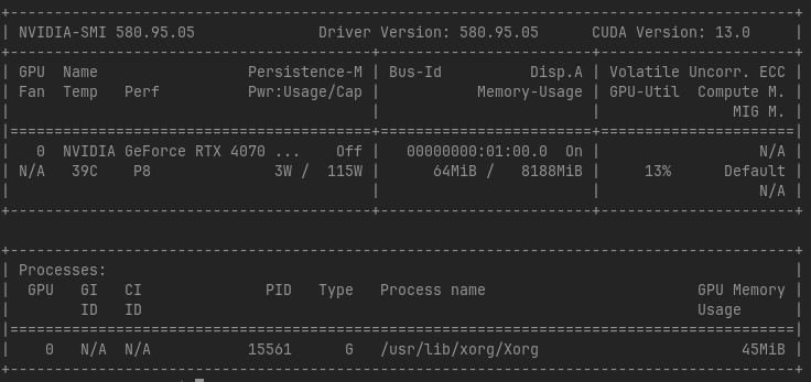

I did that and now 580 shows up in the drivers menu.
The graphics card still doesn't show up in the about menu but i just tried launching PEAK and it works perfectly.

What is your terminal output of
nvidia-smi

sudo add-apt-repository ppa:ernstp/mesarc
I ran both these commands and restarted now but it's still the same.
I should also add that in steam opening the settings and also closing it take an unusually long time (1-2 second), most things load with a delay, upon loading the libraries tab the contents of the page don't load immediately.
I will try using the 580 open driver as Ponce-De-Leon suggested.
