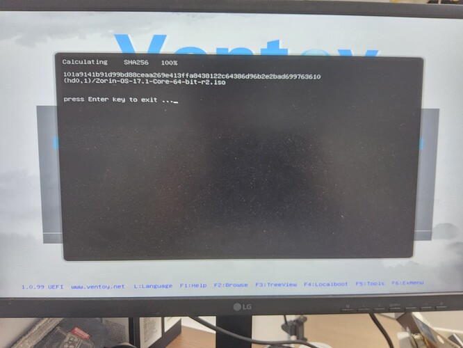

As you can see this photo, I encounter about the kernel error when I trying to install ZorinOS.
Please, can someone explain about this error? Thank you.

If the SHA256 matches the Zorin published value then I would look to a different USB stick and/or USB creation tool.
From my searches "invalid magic number" refers to failed hash check i.e. file corrupted.
Ref: boot - “Invalid magic number, you need to load the kernel first” on an existent and previously working Ubuntu installation (not live USB issue) - Ask Ubuntu
...and others
When You look here:
You should see that the Checksum is not right. It should be:
- Zorin OS 17.1 Core 64-bit:
d478f2bf2f8c7e7e680969ecc391341dc971f2cdddba47712b7da3ae524c5c96
