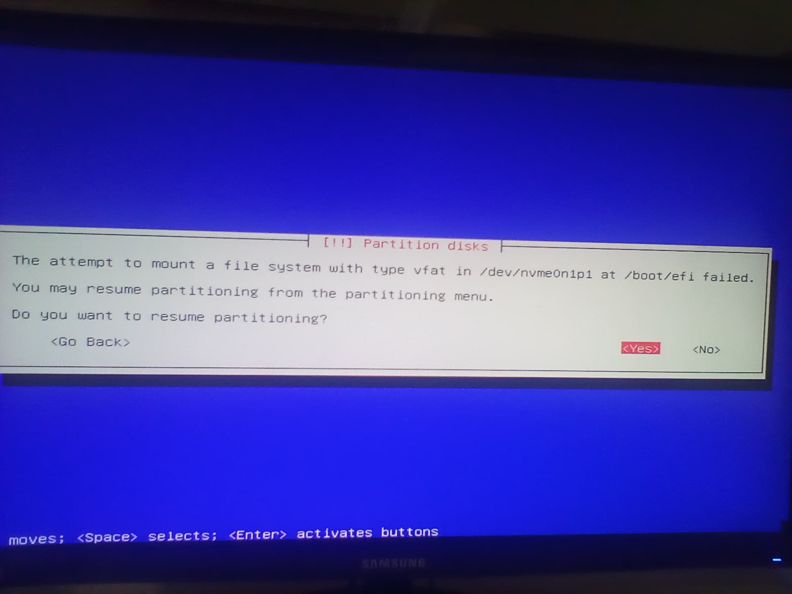

I have tried debian and that fails as well. I am attaching some screens shots.
The consistent error is " The attempt to mount a file system with type vfat in /dev/nvme0n1p1 at /boot/efi failed. This has happened with all of the installs so far.
I have done a web search and it is logged but no solutions listed and the reports have just gone dead. It seems people dont know how to fix this.
