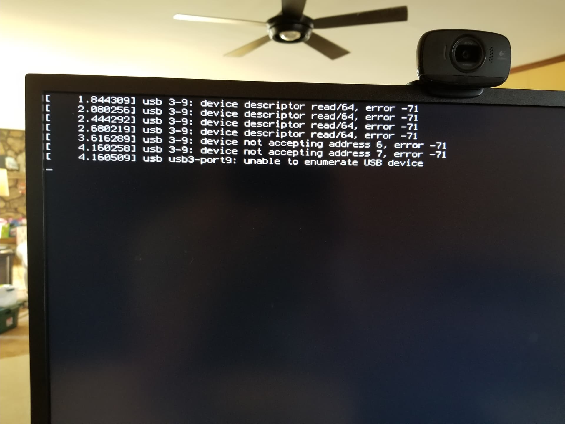

Yesterday I used Zorin 16.3 Pro with Zoom to watch a podcast. Today I installed Zorin 17 Pro but I'm getting errors and it won't recognize my Logitech WebCam via USB. Here's the error pic, can anyone assist with this problem?

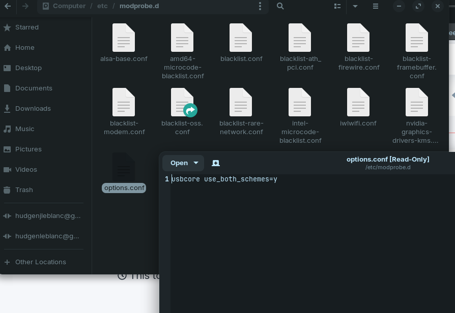

Can you please add the following to /etc/modprobe.d/options
sudo touch /etc/modprobe.d/options.conf
options usbcore use_both_schemes=y
ctrl+o to overwrite, then enter to save current configuration, then ctl+x to exit the editor.
Thanks for the reply but I'm not too good with this - is there supposed to be a file in that folder named Options? Can't find one but here's what's in the modprobe.d folder . . .
Thanks both, I neglected the .conf - edited post above.
I added the file and restarted but there is no change . . . still have error and no cam :frowning:

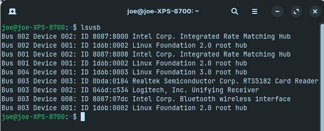

Well I tried adding modprobe.conf w/usbcore use_both_schemes=y and no change. I also tried installing libusb-dev and no change. :frowning: :frowning: :frowning:
Interesting, it now lists my usb but my cam still is not detected by a program.
usb
Wonder which made the cam pop up in lsusb :thinking: that's one good thing though!

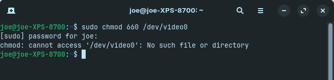

You could try sudo chmod 660 /dev/video0 to see if it's permissions issue.
If it is: you can run sudo chown root:video /dev/video0 to fix the group.
Didn't work . . .

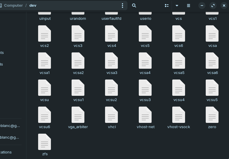

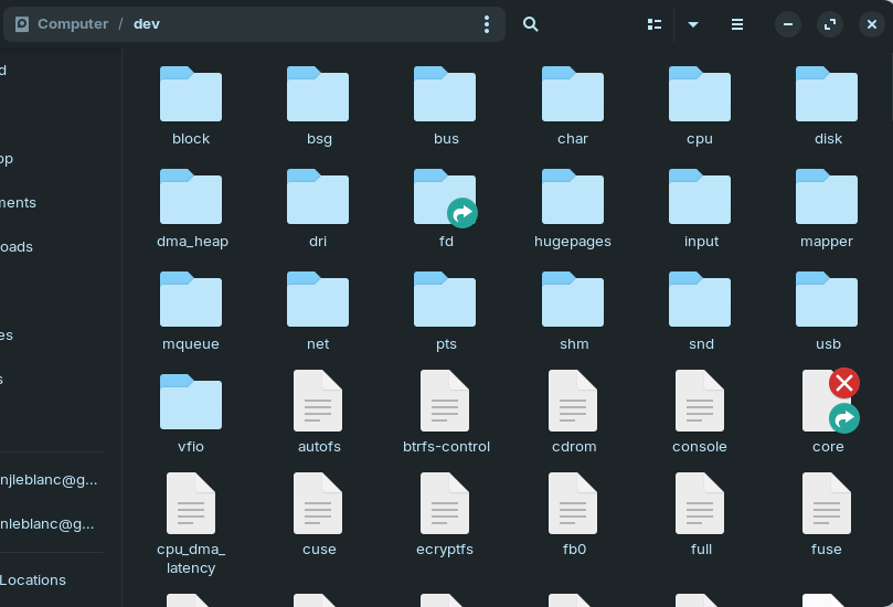

If you look in /dev, do you have any 'videoX' directories??
Nope, not there
Not a directory - my bad.. It's not a directory, it's a file :smirk:
Nope, no file either
