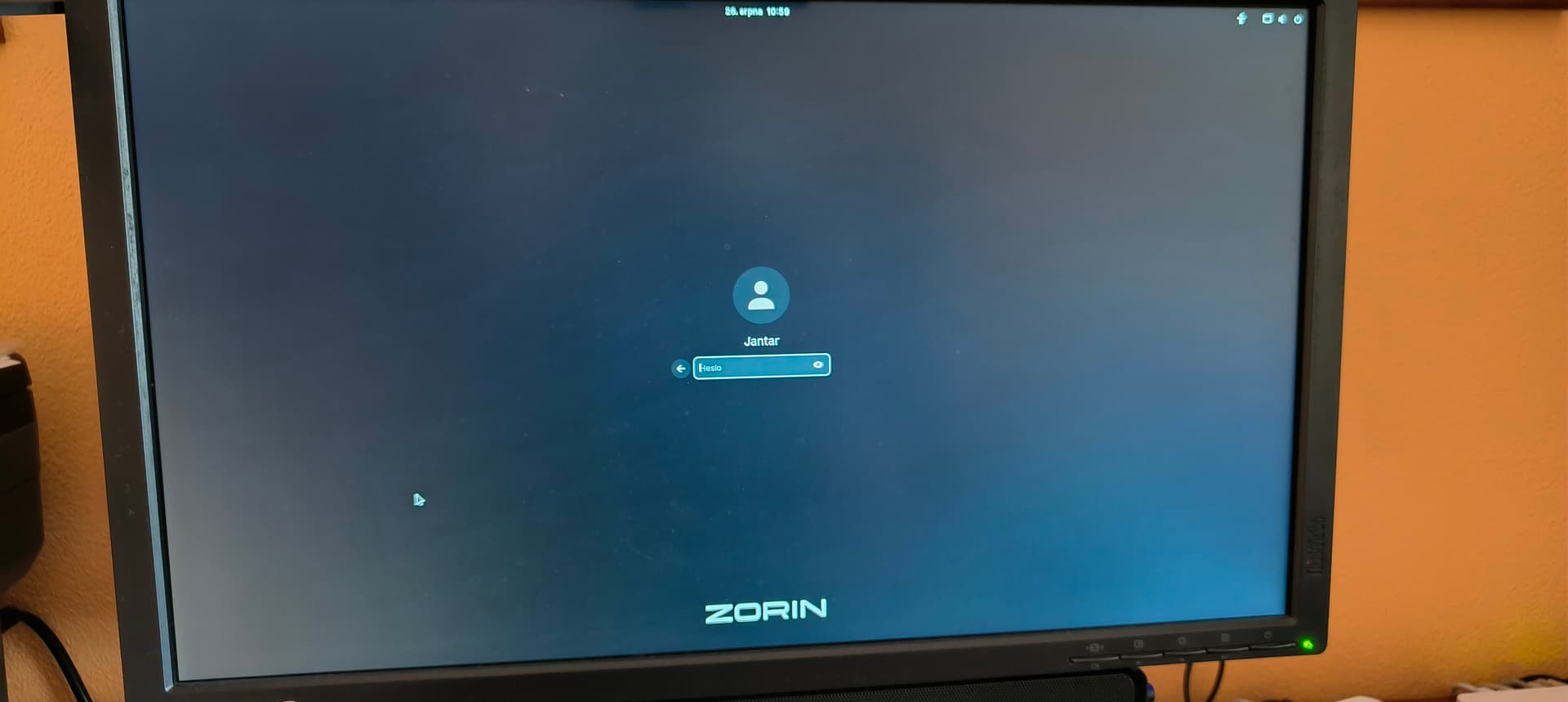

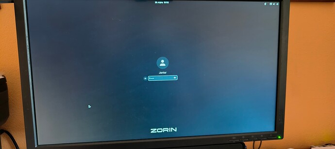

You have to login to you account first, and log out. Then you should be able to see the gear icon:
Can you double check? It would be strange that your system already is running on Xorg without you making any changes, as that is not the default. That could be a sign of something else that's causing this.
I logged in and logged out, the result is in the photo. However, the acceleration is already working for me, uninstalling Mesa-intel, cleaning and reinstalling helped me. In GRUB, I left the parameters i915.modeset.1 nomodeset vt_handoff=7 for quiet splash. The system boots up and the acceleration is working, checked via glxinfo -B and glxgears -info. Thank you all for your efforts to help.
