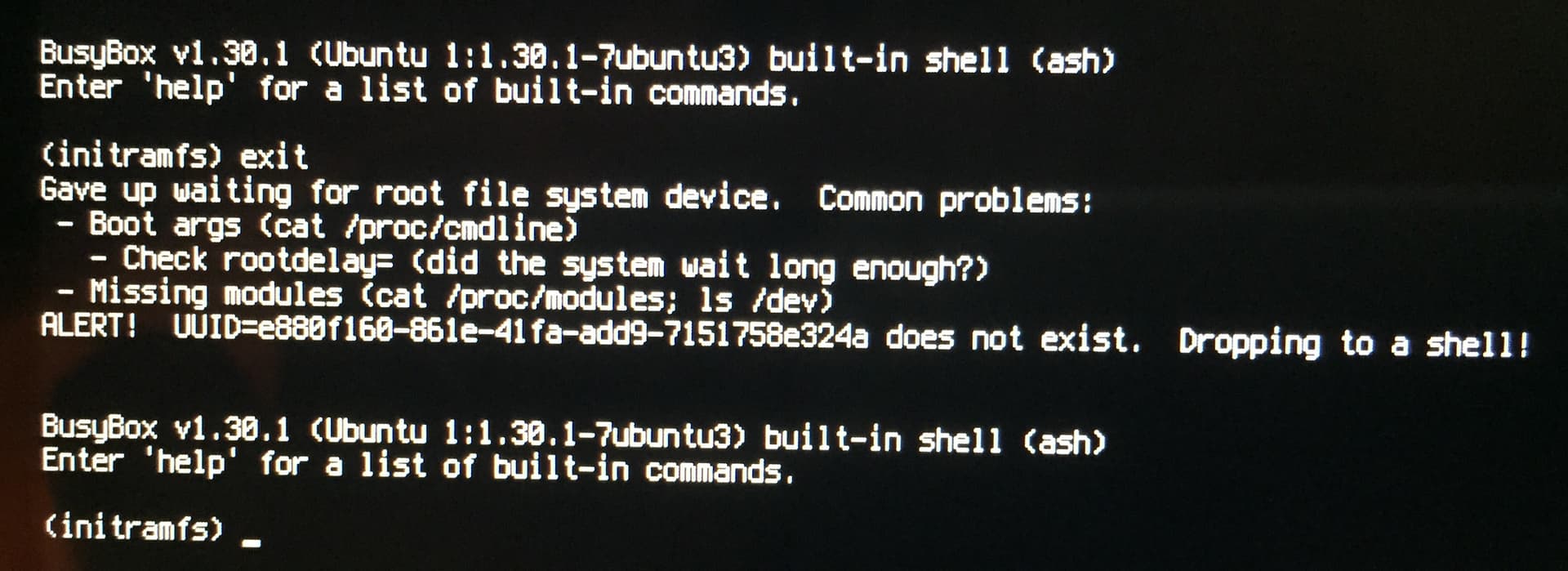

Hi, I was installing Zorin on a brand new Asus BR1204FG. I never used the pre-installed Windows but started it with the Zorin boot stick. The live system ran flawlessly, so I continued with the installation. Selected the option "Delete Windows" in the installer and activated the loading of proprietary drivers and downloading of updates. After the installation and reboot, Grub appeared with the selection of Zorin. But then the joy ended. The well known Busybox error appears. When entering exit, the following message appears.
My previous searches here in the forum or elsewhere on the net have not really got me anywhere. And my situation is also different because I don't use dualboot and there is no windows anymore. Is there a quick and easy solution to the problem?

Zorin 17 is a fork of Ubuntu 22.04. Looks like this could be a kernel error. It uses 6.8 kernel, you may need to downgrade to 6.5 kernel according to this askubuntu thread:

Ok but how to downgrade to an older kernel when I can not boot into the system? I'm not familiar with those things.

Downgrade Ubuntu 22.04 Kernel
When you cannot boot into Ubuntu 22.04 due to a kernel issue, you can attempt to downgrade to an earlier kernel using a live USB environment. Here are the steps:
  1. Boot from a live USB environment.
  2. Access your system's file system. You may need to mount your root partition.
  3. Install the older kernel version using the package manager. For example, if you want to install kernel version 5.15.0-73, you can use the command:
sudo apt-get install linux-image-5.15.0-73-generic
This command installs the specified kernel version.
  1. After installing the older kernel, reboot your system from the live USB environment and select the older kernel from the GRUB menu. To do this, press Esc during boot to show the GRUB menu, then select the older kernel from the "Advanced options for Ubuntu" menu.
  2. Once you have successfully booted into the older kernel, you can remove the newer kernel that was causing issues. To remove a specific kernel, you can use:
sudo apt-get purge linux-image-unsigned-6.1.1-0601010-generic
Replace linux-image-unsigned-6.1.1-0601010-generic with the exact name of the kernel you want to remove.
  1. To ensure that the older kernel is used by default, you can modify the GRUB configuration. Edit the /etc/default/grub file and set GRUB_DEFAULT to the name of the older kernel entry in the GRUB menu. For example:
GRUB_DEFAULT="Advanced options for Ubuntu>Ubuntu, with Linux 5.15.0-73-generic"
After editing, run sudo update-grub to apply the changes.
By following these steps, you should be able to boot into Ubuntu 22.04 using an earlier kernel version that is more stable for your system.
Just change the reference to 5.15 to 6.5.
