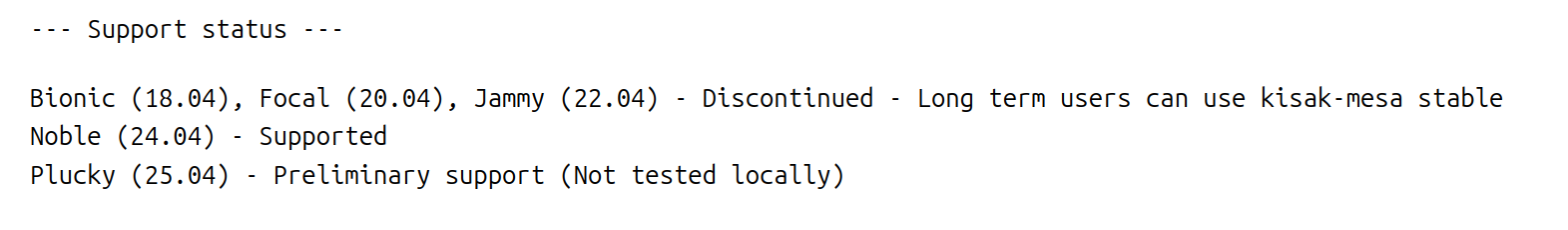

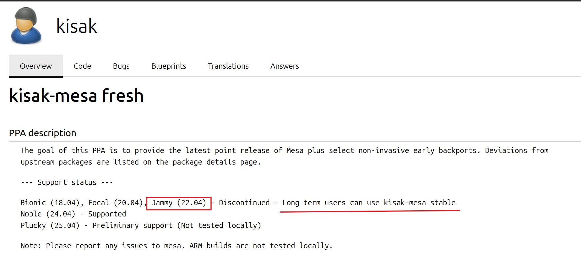

kisak fresh doesn't support Ubuntu 22.04 anymore. So, the kisak stable Repo is neccessary:

The End of the Support is relatively new. In the Past there stands a Date for the End. I don't remeber exact about it. But it was in August. So, it is not long. and it stands on the Site of the fresh PPA. Form that is my posted Picture. Here is it a bit bigger:
I asked Aravisian about this and he replied as follows:
