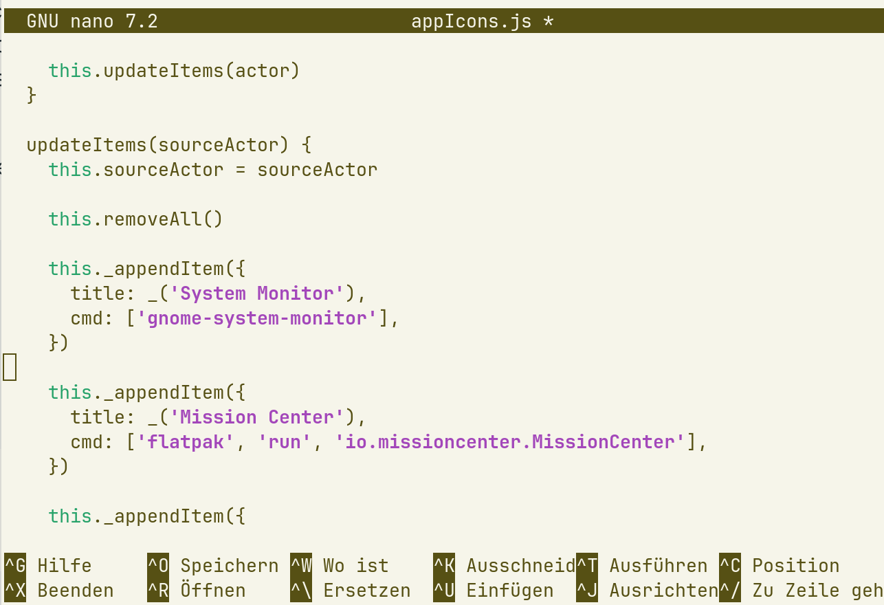

Tried to get it work, but did anywhere a mistake?
After editing the appIcons.js as you can see on the photo did a reboot, but afterwards with right click on the taskbar still appears only the "Systemmonitor", the mission center is not visible.
The mission center was installed over flatbak within the software store.
Thanks for any idea!
That looks right for me. And you have saved the file and you use Zorin taskbar? Or do you have replaced Zorin taskbar with dash to panel?

Yes, did save the file appIcons.js and verified now again looking into it's changed content. It is saved as seen on the photo.
I use the Zorin taskbar below but additional the Gnome bar above.
First I had the appIcons.js changed overwriting the System Monitor with Mission Center entries, but did not work either. But I will try that again.

After editing the file appIcons.js again and deleted the System Monitor section it works now after reboot:
  • right click on the taskbar shows the Mission Center within Context menu
  • right click on the Zorin Start Button shows the System Monitor within Context menu
Thanks for your help!
