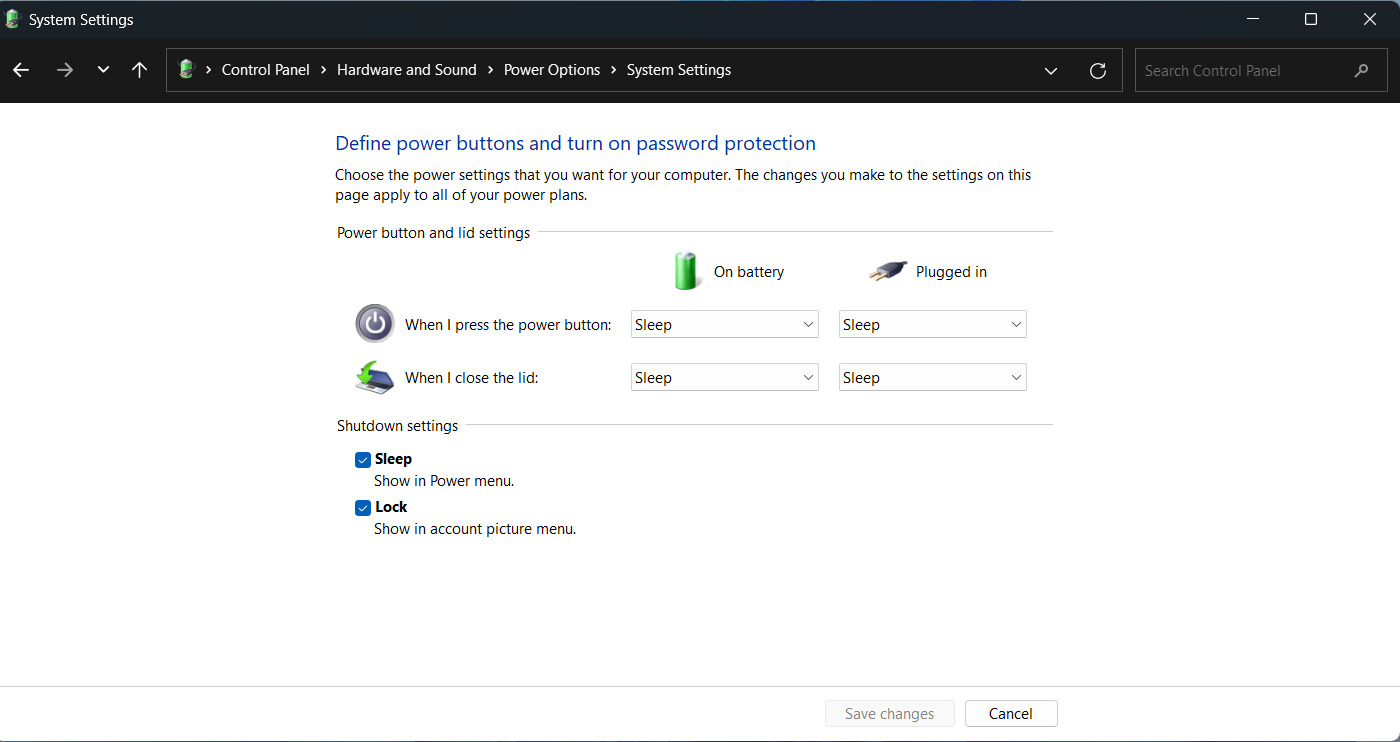

Link you gave says to disable fastboot/fast-startup from Windows and BIOS but i couldn't found such option there.
But there's a option in BIOS to disable Secure-boot, already disabled that one.
Screenshots:
Seems strange, What Windows OS are your running?
Also from HUAWEI site: Here
I found a second one also indicating to disable fast startup? Here
Added:
To check if your fast startup is disabled, we need to enable "Hibernation".
Enter into Windows, open Command prompt/shell as admin,
enter
powercfg /hibernate on
Then hit:
Enter
Now return to the power settings & 1st note if "Fast startup" is disabled or enabled?
(i wish to know if while in "Hibernation off" it had "Fast startup" disabled?)
You should now be able to disable fast startup & uncheck hibernation.
We don't want fast startup or hibernation enabled.
