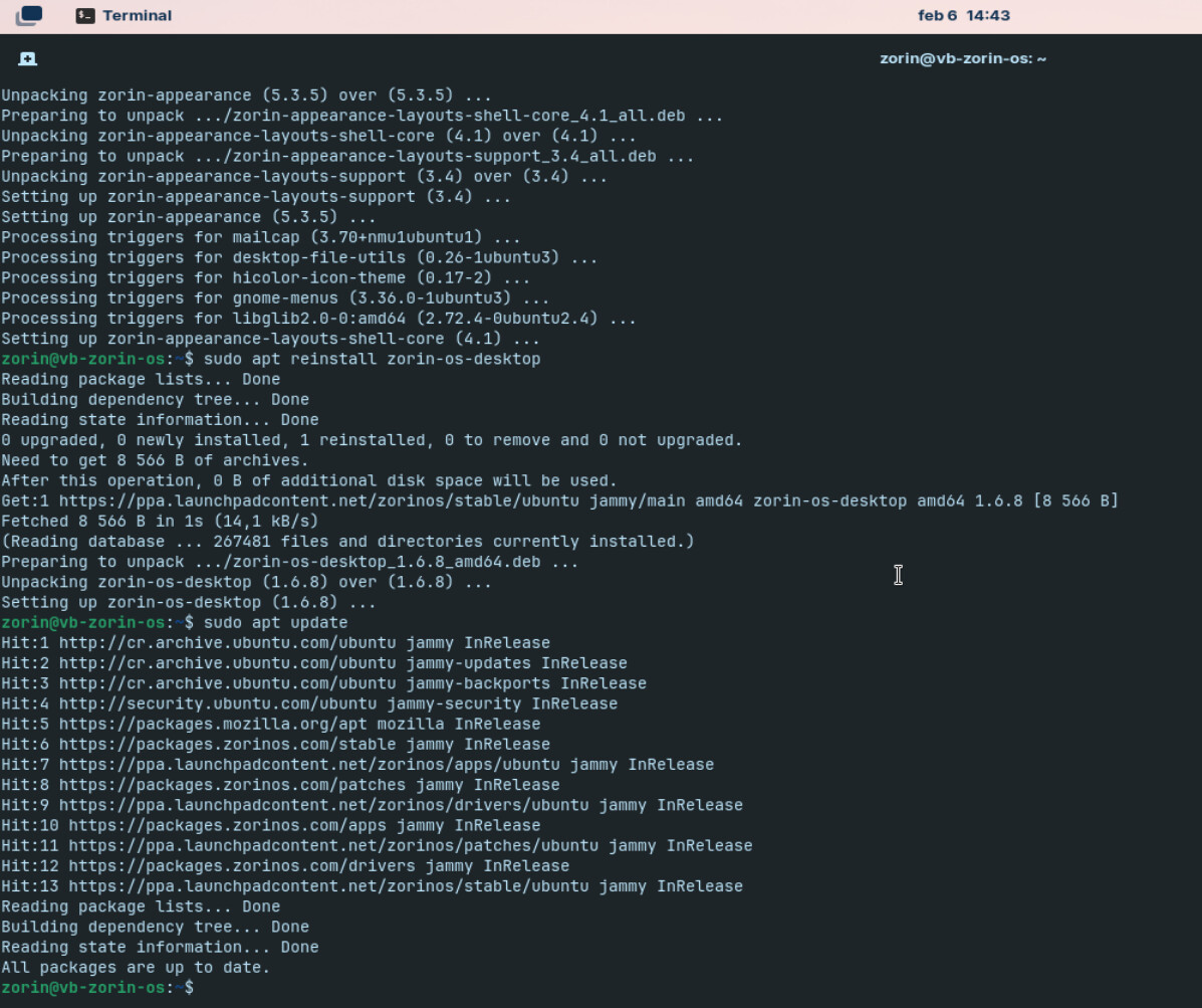

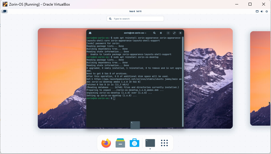

Did You tried it with a reinstall of Zorin Appearance? To do that, type in the Terminal:
sudo apt reinstall zorin-appearance zorin-appearance-layouts-shell-core zorin-appearance-layouts-support
Another Option would be to try to reinstall the Zorin Desktop itself. You can do that with the Command:
sudo apt reinstall zorin-os-desktop

After installed the first command, only the last package is missing: zorin-appearnace-layouts-shell-support
Here the output after typed the two commands:
Right now, this is how my actual desktop looks like:
I think the last package is incorrect, it should be zorin-appearance-layouts-support.
After reinstalling those (make sure to also run sudo apt update first), you can try to go into Zorin Appearance -> Theme -> Other, and click on "Reset to defaults".
Indeed there was an error in the first command, but nothing's changed.

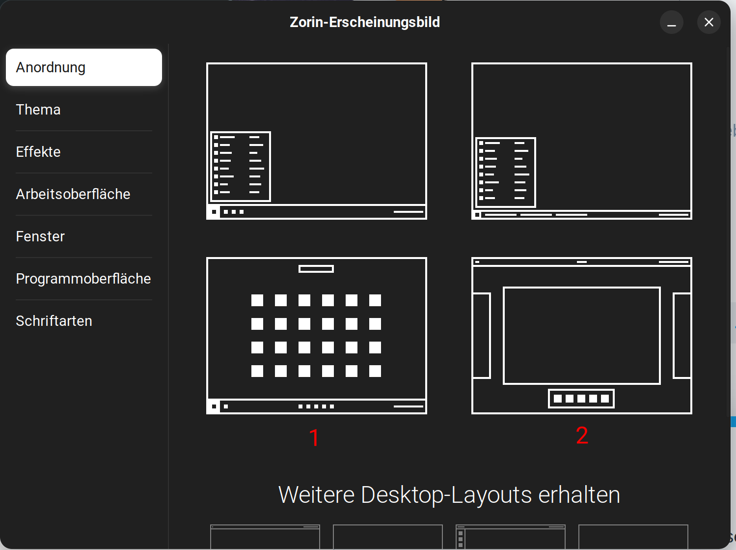

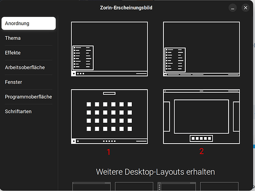

Okay, to ask that clear. Which Layout You choosed in Zorin Appearance. 1 or 2:

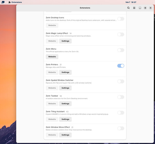

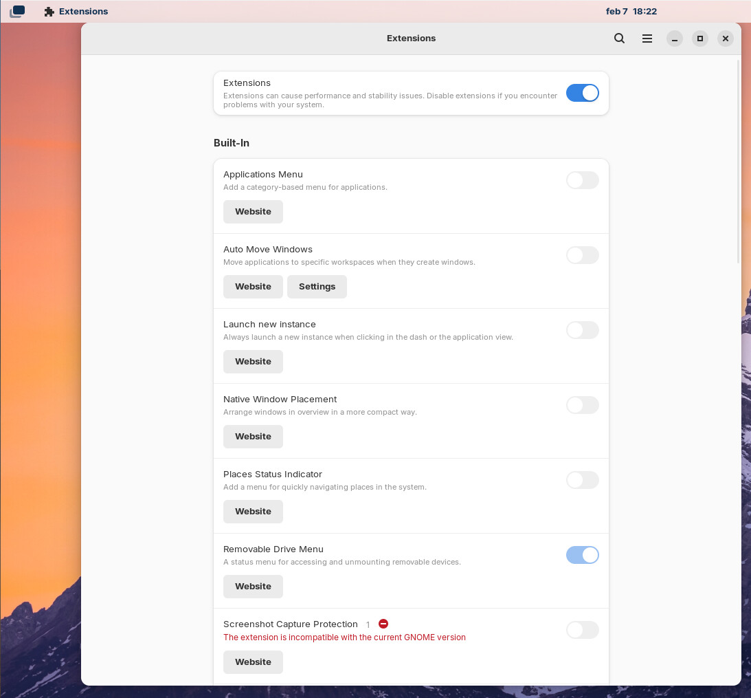

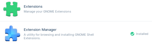

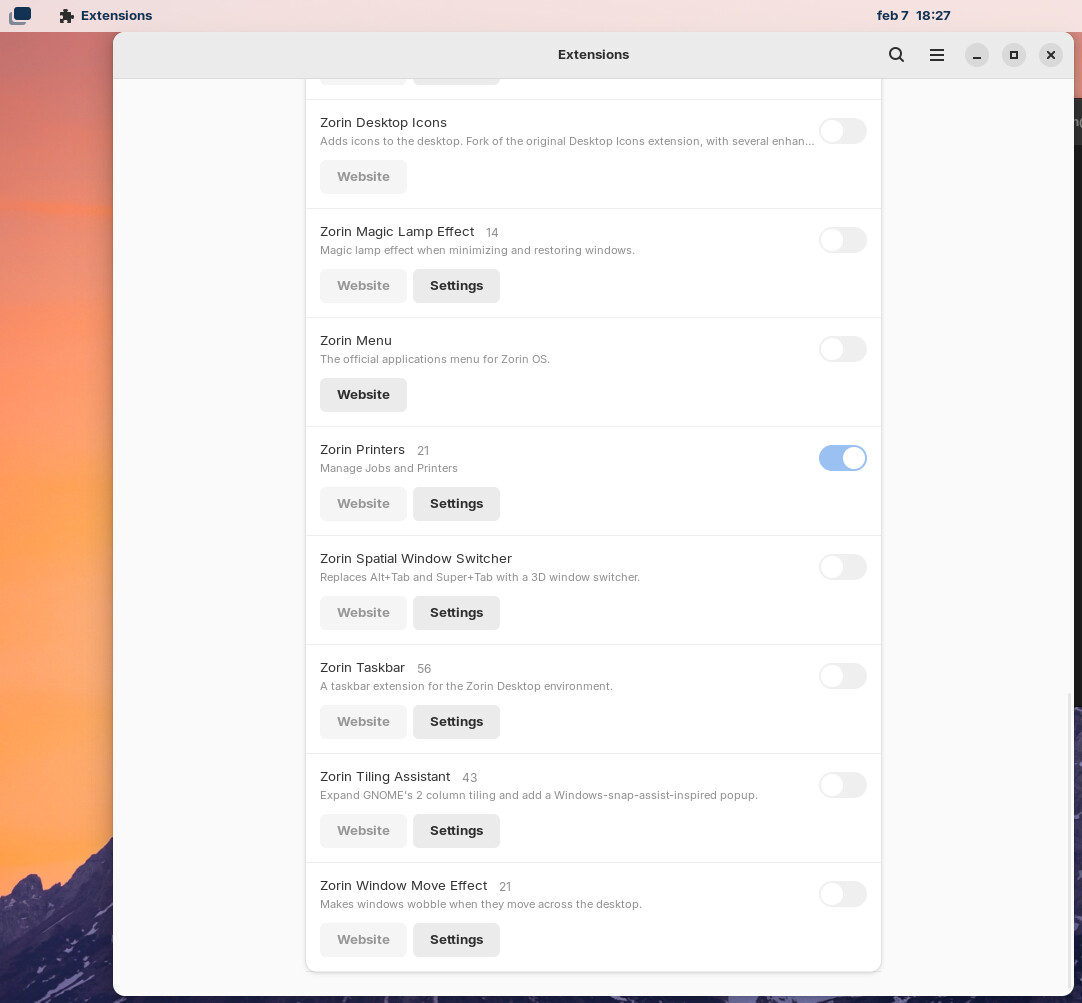

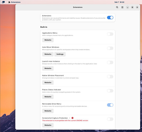

And we should control the Extensions, too. Go to Gnome Software (the blue Bag Symbol with the white Circle) and there search for the Extension Manager:
It is a tool for managing Gnome Extensions. Install it and open it and on the ''Installed'' Tab look for Zorin Taskbar and Zorin Menu and turn the Toggle on.

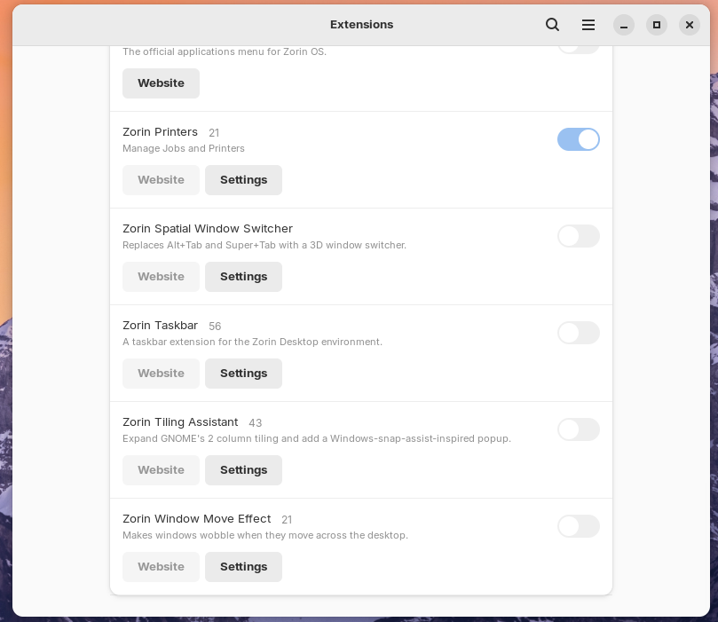

I was thinking about the same thing, as I've run across times where the extensions got turned off, which caused me to lose my Zorin appearance in the past.
Make sure User Themes is enabled...
Yes I know I have Zorin Dash turned off on mine, I am using an alternative, but you should have everything "Zorin" turned on in there.
I installed extensions and discovered that many Zorin options were disabled; however, they cannot be enabled as they all appear grayed out, like in "read-only" mode.
Any idea why?

I was using number 1 and also don't have a single problem with the default theme.
As @Ponce-De-Leon described, install Extension Manager.

Here's the capture I started just before opening Zorin Appearance, then tried to set one of Layouts, and the rest of the output when I hit Themes > Other > Reset to Defaults.
That's it.

Unfortunately, that doesn't seem to help too much :slightly_frowning_face:

Hmm ... the Extensions are there ...
