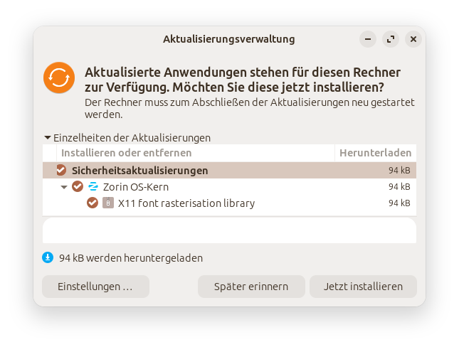

Thank you. It seems I am on 6.17 still, but the update manager say I need to reboot for some changes to occur. Might be the Kernel update as I run sudo apt update & upgrade frequently as I thought thats generally recommended :innocent:
Can I do something (easily...) about that at this stage? :grimacing:
Set kernel 6.17 as default when you have booted with it. Then it doesn't matter when kernel 7.0 is installed.
In this case, the update-manager is more comfortable to unselect updates than the terminal.
It should show a List with the affected Packages. Are there Kernel Packages? Can You make a Screenshot of it and post it here?
Now it is showing some new updates, but before it was just the window telling to reboot. No details there...
Thank you.
I might try that or even just wait for some mor updates until the next reboot. Lets see if that plays out :slight_smile:
You can also simply access Zorin's Advanced Options every time you boot up and select a kernel from there. If you don't reboot that often, this is the easiest way if booting with older kernels is only temporary. It's just something that can happen quickly: you might forget it.

I did this and the Zorin Updater is trying to delete my 6.17 kernel.
Which 6.17 Kernel? The one with the -35 at the End or the one with the -40 at the End?
