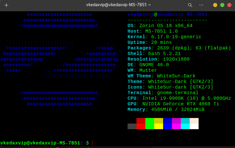

vkedaxvip@vkedaxvip-MS-7B51:~$ uname -r
6.17.0-19-generic
vkedaxvip@vkedaxvip-MS-7B51:~$ dpkg --list | grep linux-image
ii linux-image-6.14.0-37-generic 6.14.0-37.37~24.04.1 amd64 Signed kernel image generic
ii linux-image-6.17.0-14-generic 6.17.0-14.14~24.04.1 amd64 Signed kernel image generic
ii linux-image-6.17.0-19-generic 6.17.0-19.19~24.04.2 amd64 Signed kernel image generic
ii linux-image-generic-hwe-24.04 6.17.0-19.19~24.04.2 amd64 Generic Linux kernel image

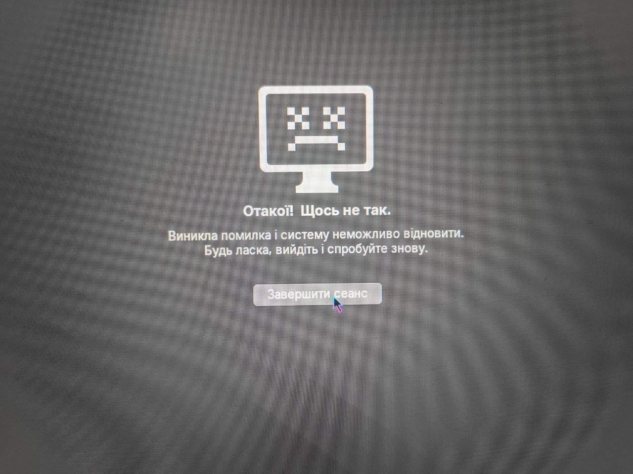

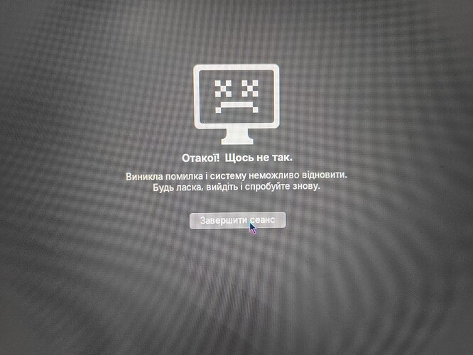

I caught this window, rebooted, and after 5-10 minutes this window appeared again, and it happened after an update, kernel or themes that recently appeared there - if you looked at the update logs there was just a theme and most likely that's it!

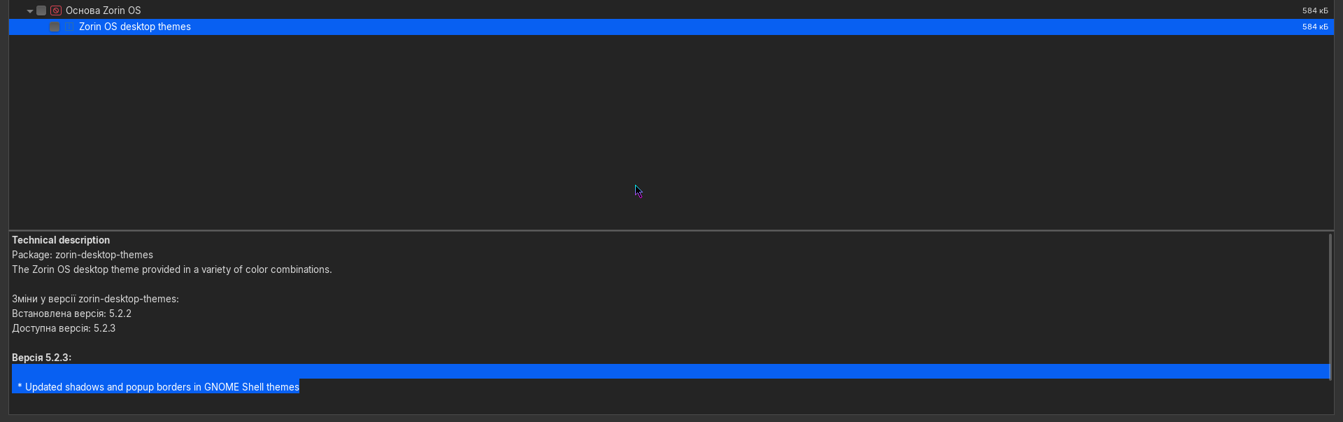

the same errors this update was recently and it is related to themes, I don't know what was there but they broke something for sure I'll go to the Bazzite something these updates in Zorin flatter me, no install a stable system and use it but let's update and break everything, that's why I left Windows here the same perspective is enough for me!

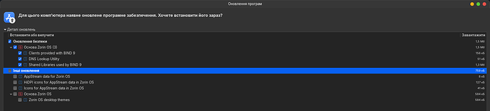

The errors started at 14:24:20, everything was fine before that, now the errors are specifically on the nvidia video card!!

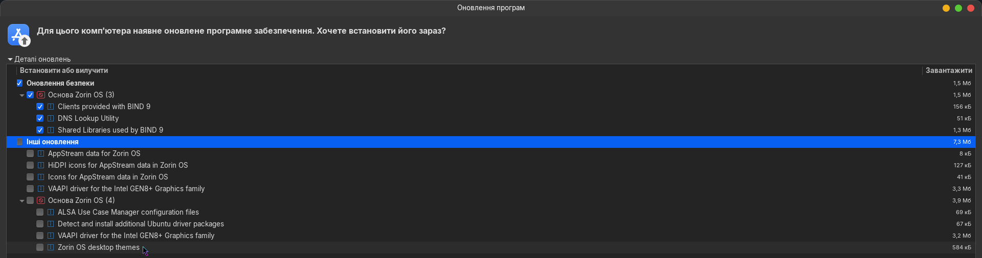

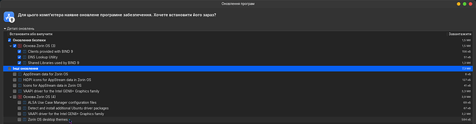

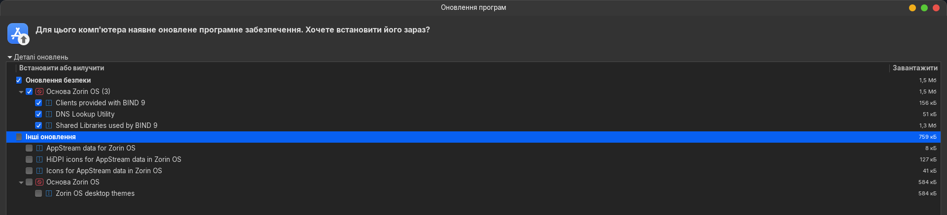

vkedaxvip@vkedaxvip-MS-7B51:~$ cat /var/log/apt/history.log | grep -E "Start-Date: 2026-03-(25|26)" -A 5
Start-Date: 2026-03-25 02:15:11
Commandline: aptdaemon role='role-commit-packages' sender=':1.146'
Upgrade: zorin-desktop-themes:amd64 (5.2.2, 5.2.3)
End-Date: 2026-03-25 02:15:12
Start-Date: 2026-03-26 06:21:04
Commandline: /usr/bin/unattended-upgrade
Upgrade: bind9-host:amd64 (1:9.18.39-0ubuntu0.24.04.2, 1:9.18.39-0ubuntu0.24.04.3), bind9-dnsutils:amd64 (1:9.18.39-0ubuntu0.24.04.2, 1:9.18.39-0ubuntu0.24.04.3), bind9-libs:amd64 (1:9.18.39-0ubuntu0.24.04.2, 1:9.18.39-0ubuntu0.24.04.3)
End-Date: 2026-03-26 06:21:06
Start-Date: 2026-03-26 13:29:00
Commandline: aptdaemon role='role-commit-packages' sender=':1.173'
Upgrade: ubuntu-drivers-common:amd64 (1:0.9.7.6ubuntu3.5, 1:0.9.7.6ubuntu3.6), appstream-data-zorin-os-icons-hidpi:amd64 (1.7.4, 1.8.4), alsa-ucm-conf:amd64 (1.2.10-1ubuntu5.9, 1.2.10-1ubuntu5.10), appstream-data-zorin-os:amd64 (1.7.4, 1.8.4), appstream-data-zorin-os-icons:amd64 (1.7.4, 1.8.4), intel-media-va-driver:amd64 (24.1.0+dfsg1-1ubuntu0.1, 24.1.0+dfsg1-1ubuntu0.2), intel-media-va-driver:i386 (24.1.0+dfsg1-1ubuntu0.1, 24.1.0+dfsg1-1ubuntu0.2)
End-Date: 2026-03-26 13:29:04

бер 26 16:42:47 vkedaxvip-MS-7B51 gnome-shell[2371]: Can't update stage views actor unnamed [MetaWindowActorX11] is on because it needs an allocation.
бер 26 16:42:47 vkedaxvip-MS-7B51 gnome-shell[2371]: Can't update stage views actor unnamed [MetaSurfaceActorX11] is on because it needs an allocation.
бер 26 16:42:54 vkedaxvip-MS-7B51 gnome-shell[2371]: Can't update stage views actor unnamed [ShellTrayIcon] is on because it needs an allocation.
бер 26 16:42:54 vkedaxvip-MS-7B51 gnome-shell[2371]: Can't update stage views actor unnamed [MetaWindowActorX11] is on because it needs an allocation.
бер 26 16:42:54 vkedaxvip-MS-7B51 gnome-shell[2371]: Can't update stage views actor unnamed [MetaSurfaceActorX11] is on because it needs an allocation.
бер 26 16:43:56 vkedaxvip-MS-7B51 gnome-shell[2371]: Can't update stage views actor unnamed [MetaWindowActorX11] is on because it needs an allocation.
бер 26 16:43:56 vkedaxvip-MS-7B51 gnome-shell[2371]: Can't update stage views actor unnamed [MetaSurfaceActorX11] is on because it needs an allocation.
бер 26 16:44:17 vkedaxvip-MS-7B51 gnome-shell[2371]: Can't update stage views actor unnamed [MetaWindowActorX11] is on because it needs an allocation.
бер 26 16:44:17 vkedaxvip-MS-7B51 gnome-shell[2371]: Can't update stage views actor unnamed [MetaSurfaceActorX11] is on because it needs an allocation.
бер 26 16:50:00 vkedaxvip-MS-7B51 gnome-shell[2371]: Can't update stage views actor unnamed [MetaWindowActorX11] is on because it needs an allocation.
бер 26 16:50:00 vkedaxvip-MS-7B51 gnome-shell[2371]: Can't update stage views actor unnamed [MetaSurfaceActorX11] is on because it needs an allocation.

vkedaxvip@vkedaxvip-MS-7B51:~$ echo $XDG_SESSION_TYPE
x11
vkedaxvip@vkedaxvip-MS-7B51:~$ nvidia-smi
Fri Mar 27 01:47:09 2026
| NVIDIA-SMI 590.48.01 Driver Version: 590.48.01 CUDA Version: 13.1 |
| GPU Name Persistence-M | Bus-Id Disp.A | Volatile Uncorr. ECC |
| Fan Temp Perf Pwr:Usage/Cap | Memory-Usage | GPU-Util Compute M. |
| | | MIG M. |
| 0 NVIDIA GeForce RTX 4060 Ti On | 00000000:01:00.0 On | N/A |
| 0% 44C P5 13W / 100W | 3569MiB / 16380MiB | 38% Default |
| | | N/A |
| Processes: |
| GPU GI CI PID Type Process name GPU Memory |
| ID ID Usage |
| 0 N/A N/A 2173 G /usr/lib/xorg/Xorg 180MiB |
| 0 N/A N/A 2363 G /usr/bin/gnome-shell 42MiB |
| 0 N/A N/A 2645 G /usr/bin/coolercontrol 131MiB |
| 0 N/A N/A 8229 G ...nstallation/ubuntu12_32/steam 3MiB |
| 0 N/A N/A 8488 G ./steamwebhelper 3MiB |
| 0 N/A N/A 8530 C+G ...on/ubuntu12_64/steamwebhelper 5MiB |
| 0 N/A N/A 9929 G ...mapps/common/JAMs/JAMs.x86_64 14MiB |
| 0 N/A N/A 11628 C+G ...ommon\Blind Box\Blind Box.exe 1327MiB |
| 0 N/A N/A 281893 C+G ...\TCGMaster-Win64-Shipping.exe 1655MiB |
| 0 N/A N/A 284948 C+G ...rack-uuid=3190708988185955192 78MiB |
The main reason is that developers are constantly getting into these themes and breaking things!!
On top of that, these Zorin updates are breaking the system and can't be turned off.
Why, when I have only "security patches" enabled = I get these Zorin themes now? That's what broke my system!
Can't developers just stop at security patches? Let's figure out why people switched from Windows for these reasons, and this is exactly what's happening with Zorin, a system that's up to 2029 and has already been broken 2-3 times in 5 months of use.
NO MORE UPDATES - no need for themes, icons or anything else that breaks gnome and the system, I highly doubt anyone is testing this, given the problems.
all updates were with such tricks, these are themes and icons!!
with the new core my RTX4060Ti just read like everything was okay although in the logs it was noticeable without any unnecessary issues, launching any game - the game just froze and that's it.
Zorin Desktop Theme - NEVER UPDATE UNDER ANY CONDITIONS!!
anything related to Zorin icons - also avoid!
in addition it breaks your existing and working gnome extensions!
if the kernel can be changed - when the system starts, other updates to the system itself break everything to the root!
Zorin OS desktop theme - breaks gnome shell extension - Vitals in logs: invalid pointer
that's not all, also another extension - Desktop Widgets (Desktop Clock), began to lead the system to white screens of death, as in the photo above.
of the suspects other extensions that could have been affected:
Blur my shell and Rounded Window Corners Reborn.
finally I declare that if you disable the system extension in Zorin: Light Style you will stop messing with shortcuts on the desktop every time you log in to the system!
I don't know how to test all this to even break some of the system extensions.
maybe the logic is that a person installs their Zorin system and uses it without changing anything at all, without installing any programs or extensions?!
if this is so, then there are others that give more options, system customization, while not breaking anything with updates.
In principle, I found the culprit, rolled back the system, and I don't plan to update anything more than security patches until 2029.
Themes do not break things. The Zorin Themes and icons in the update did not break anything. You are jumping to a conclusion because Zorin Themes were included in the updates, even as you ignore the other system packages that were included in the updates.
They can... and not only can you turn off automatic updates, you can disable update notifications.
