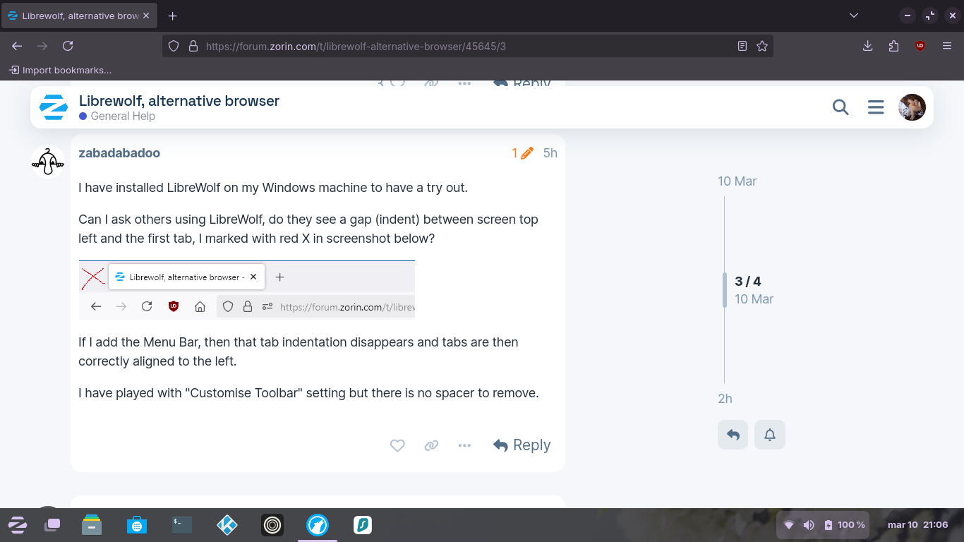

Can I ask others using LibreWolf, do they see a gap (indent) between screen top left and the first tab, I marked with red X in screenshot below?
indent tab
If I add the Menu Bar, then that tab indentation disappears and tabs are then correctly aligned to the left.
I have played with "Customise Toolbar" setting but there is no spacer to remove.
Hmm ... if I'm not wrong, this should be the Space where in the normal Firefox an Icon is ... I think this should be Firefox View. But You can remove it and then the Tab should automatically move to the left.
Is this what you mean, @zabadabadoo? Mine doesn't look the same... I picked another "theme", so maybe you could try that?

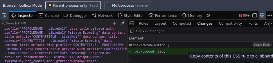

I don't see it, either. You can take a closer look (and remove it) by using the browser's developer tools:
  1. Open the developer tools by pressing Ctrl+Shift+I. Click on the ellipsis icon on the right hand side, and select settings.
  2. Make sure "Enable remote debugging" enabled.
  3. Close the developer tools and press Ctrl+Shift+Alt+I. This will bring up a new prompt that you must accept, to gain access to the developer tools.
  4. Click on the little arrow cursor and hover it around to see the different elements. Click on the empty space should lock it and show it exactly in the HTML view. From there you can make any CSS changes in real time, although only for the duration of the session.
  5. To make the changes permanent you need to enable toolkit.legacyUserProfileCustomizations.stylesheets inside of about:config.
  6. Locate your profile folder by going into about:profiles.
  7. Create a new folder (if not already created) called chrome, and inside of that create a new file called userChrome.css.
  8. Here you can write the CSS rules that will take effect next time you restart your browser.
  9. To know exactly which rules you need to write, click on the "Changes" tab and copy the rules that you want. For example, as per my previous screenshot to turn the new tab button red:
    Click on the "Copy rule" button to copy the rule and the right selector. In your case, to make that space disappear, you can use display: none instead of my background: red.
Thanks zenzen, I will take a look when I have time. It is not affecting performance and sometimes corrects itself, which is also strange.
I don't know which browser your instructions refer to a Developer Mode seems different in LibreWolf and no arrow appears.
Also you mention chrome twice and LibreWolf is a fork of Firefox and not chrome based, so I'm thinking you are referring to a chrome based browser.
Those are instructions for Firefox, but they'll work fine on LibreWolf — it's what I used to take those screenshots — and other forks as well, unless those forks have specifically changed this.
The mentions to "chrome" do not mean Google Chrome nor Chromium, it's just the name that is commonly used to refer to the UI layer in some programs. When Firefox starts, it'll search for customizations inside this folder and specifically in a file called "userChrome.css". It's just an unfortunate coincidence.
In my first screenshot I've marked the "arrow cursor" icon in Step 1. It appears at the top left corner, next to the "Inspector" tab.
Perhaps I could write a post in Tutorials & Guides to to explain all of this in more detail, and with clearer instructions. I'll try to get to it later today.
Please ignore the tab indent issue I raised in my post #3.
Looking at LibreWolf webpage https://librewolf.net , it is that same, see screenshot.
It is just a bit weird that it is different from Firefox at startup, then seems to correct itself during use. I currently have 2 tabs open and they are left justified like Firefox. The weirdness does not impact on use and I find it faster than FF.
