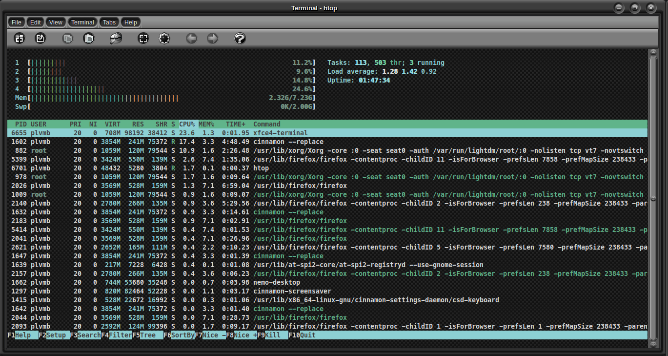

You might consider using htop to display memory usage, then run htop in terminal and let it run while you work on other tasks and go about your normal computering business- IF you notice a slow down or performance drop, look at the terminal window running htop for a large wad of memory being gobbled up.
sudo apt install htop
htop
and you can relay that output here.
Here is an example of htop running on my machine:
