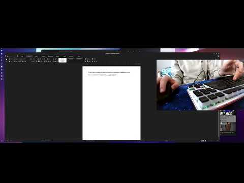

I made a youtube link demonstrating my issue
Thank You for the Video. It shows it good. So, the Problem is, that it lags when You click at the Side Buttons from the Mouse and at the same Time Buttons on Your Keyboard.
To ask that: You set it up on Windows with the Software. Then You wrote that it didn't fix the Issue. Do You have this Issue on Windows, too?
I would think that the Processing of both Inputs at the same Time is simply too much. So it can't handle this Input and it gives this Lag. You demonstrate it in Your Video: When You make it not at the same Time it works without Problems - even when You click it fast.
