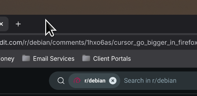

Not sure how to fix this, but I'll attach a screenshot of the cursor hovering brave vs chrome for an example.
NOTE: I just tried switching away from Adwaita cursor and that did seem to fix it... the other cursors are terrible, so I'd like to keep Adwaita.
Any ideas on what I should do to fix this?
Chrome:
Brave:
Edit: I'm reviewing the screenshots, and somehow the screenshots made the cursor look normal in both images... No idea why because that is NOT what I'm seeing on my screen.

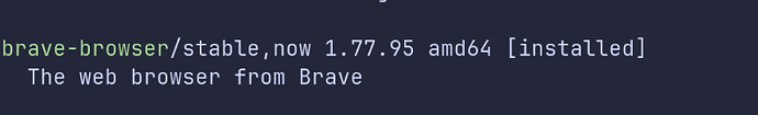

If it helps, I updated the system yesterday, which included a brave update from package version 1.76.82 to 1.77.95.

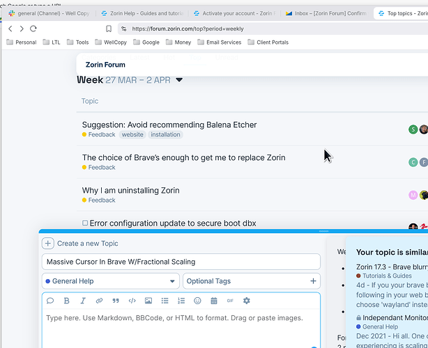

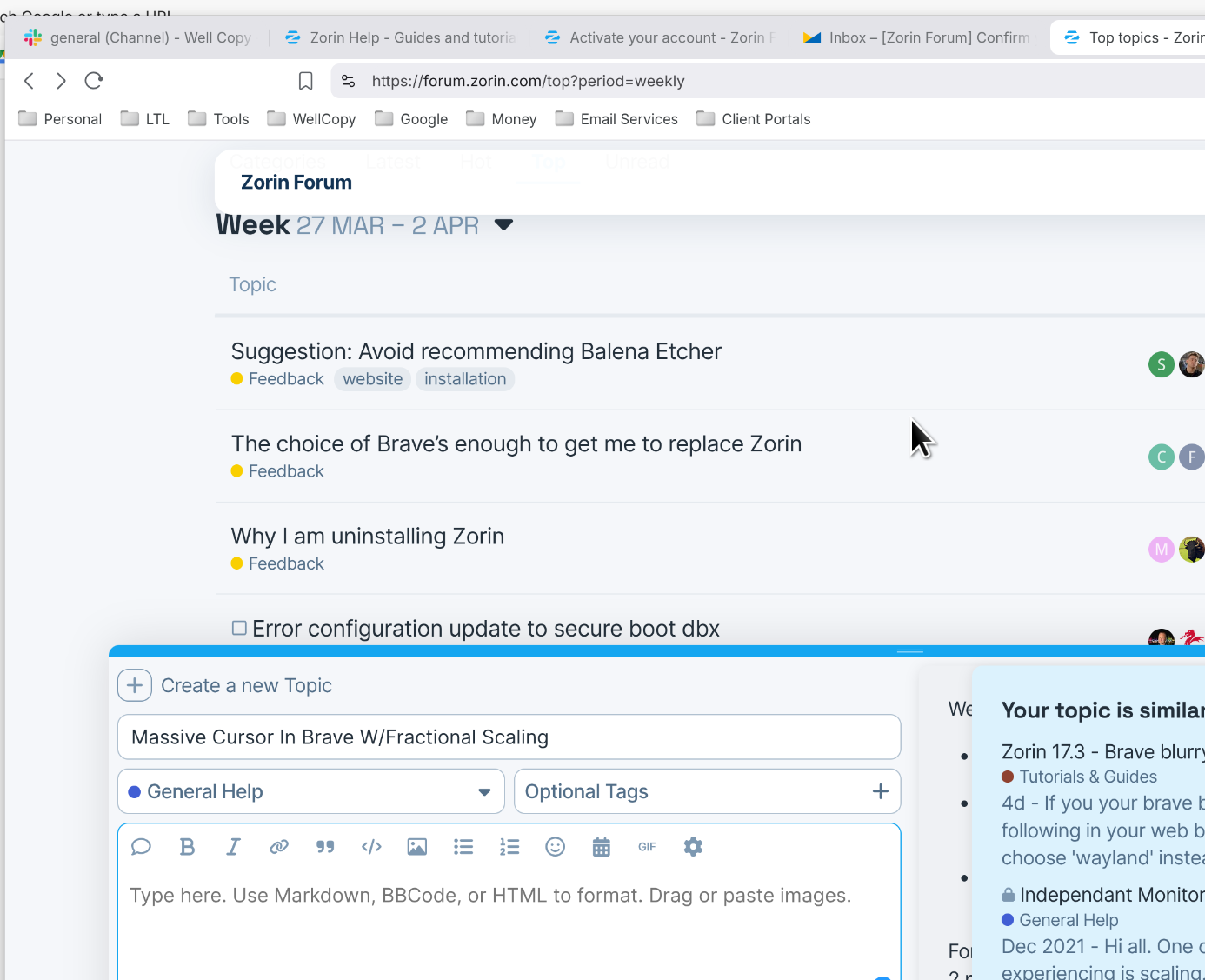

Better screenshots to show the cursor difference:
Normal:
Brave:

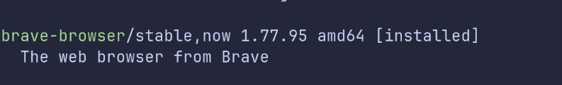

Is Brave installed as a Flatpak?
If this is a default install... the ZorinGroup stated that Brave Browser will be supplied by APT by default. But let's check anyway.
Its installed from APT
