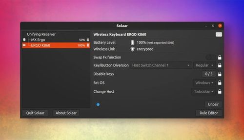

Install Solaar, a package to control Logitech devices via Terminal:
sudo apt install solaar
solaar

It's not working.

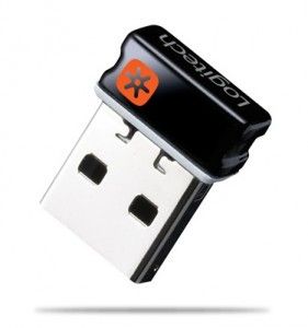

It is possible that you have a model that solaar does not work with. Using Brave A.I. super crawler engine with Ubuntu 22.04 as search criteria as that is what Zorin 17 is built on comes back with:
Logitech M90 Mouse Not Working with Solaar on Ubuntu 22.04
The Logitech M90 mouse may not be detected by Solaar on Ubuntu 22.04 due to compatibility issues or missing configuration. While Solaar supports the majority of Logitech Unifying devices, not all models are compatible, and the M90 might not be on the supported list. First, verify your Solaar version, as Ubuntu 22.04 includes a newer version (1.1.1) that should be sufficient for many devices. If you have an older version, update it using the official PPA: sudo add-apt-repository ppa:solaar-unifying/stable followed by sudo apt update and sudo apt install solaar .
Ensure the necessary udev rules are in place. Check for the file /etc/udev/rules.d/42-logitech-unify-permissions.rules and, if missing, install it from the Solaar GitHub repository. Reload the udev rules with sudo udevadm control --reload-rules and then unplug and replug the Unifying receiver. Additionally, confirm your user is part of the plugdev group, as this is required for device access; log out and back in after adding yourself to the group.
If the mouse still isn't detected, it could be a kernel module conflict. Check if the hid_logitech_dj module is loaded with lsmod | grep logi . If so, it might interfere with Solaar; you can blacklist it by creating a file /etc/modprobe.d/blacklist.conf with the line blacklist hid_logitech_dj , then run sudo rmmod hid_logitech_dj and replug the receiver. For further troubleshooting, use the solaar -d command to view debug output.

Solaar isn't detecting the mouse , its a wired mouse not wireless.
I looked up that mouse, it appears to be a basic 12 dollar office mouse model. I have a Logitech G502 gaming mouse, and I can confirm, it shows up on the Solaar APP. I'm using a SteelSeries Aerox 5 mouse now days though.
