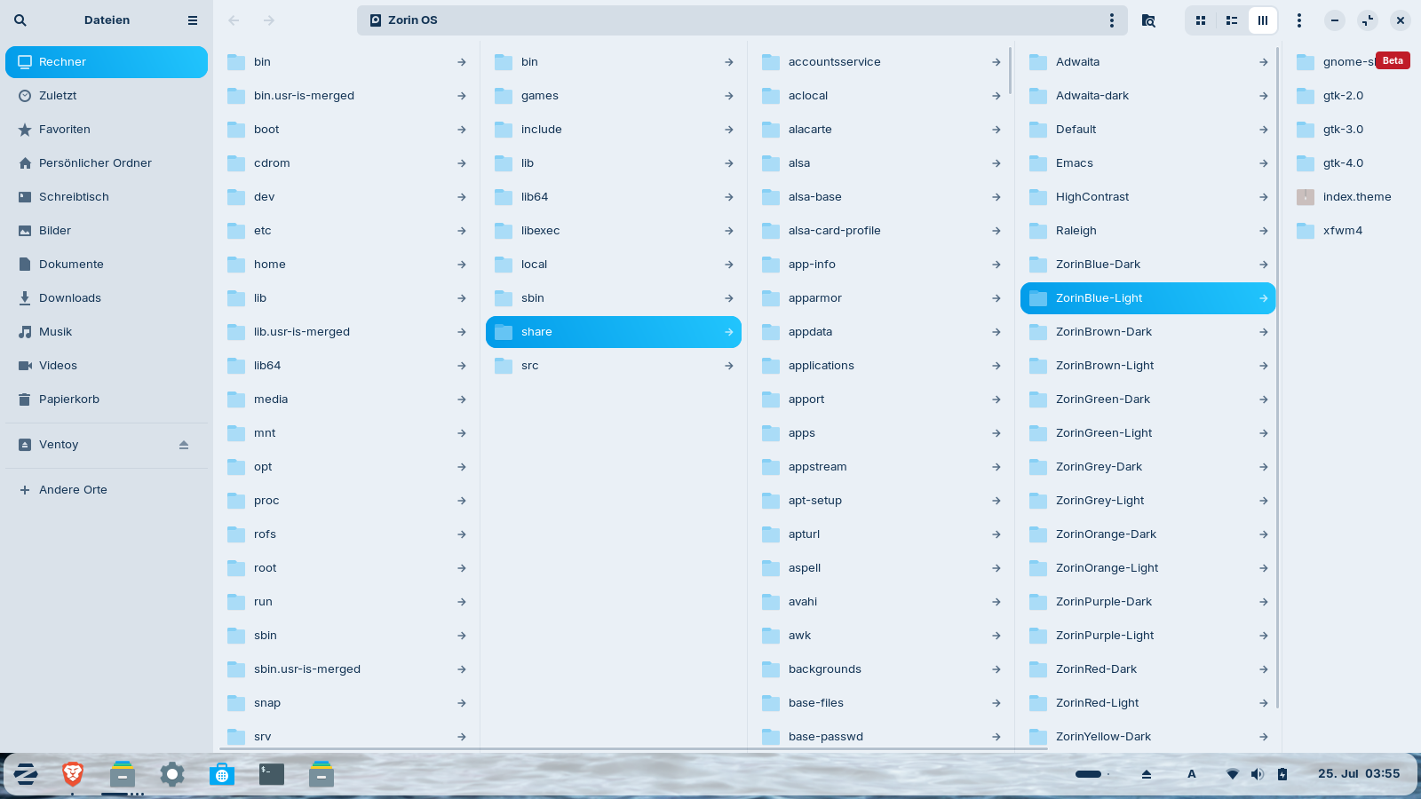

I discovered this today and tested it in a live session of Zorin 18.1. The installation script ran a bit strangely and reported errors. But I was able to take a look at the new features; however, the Miller columns are still in the beta phase.

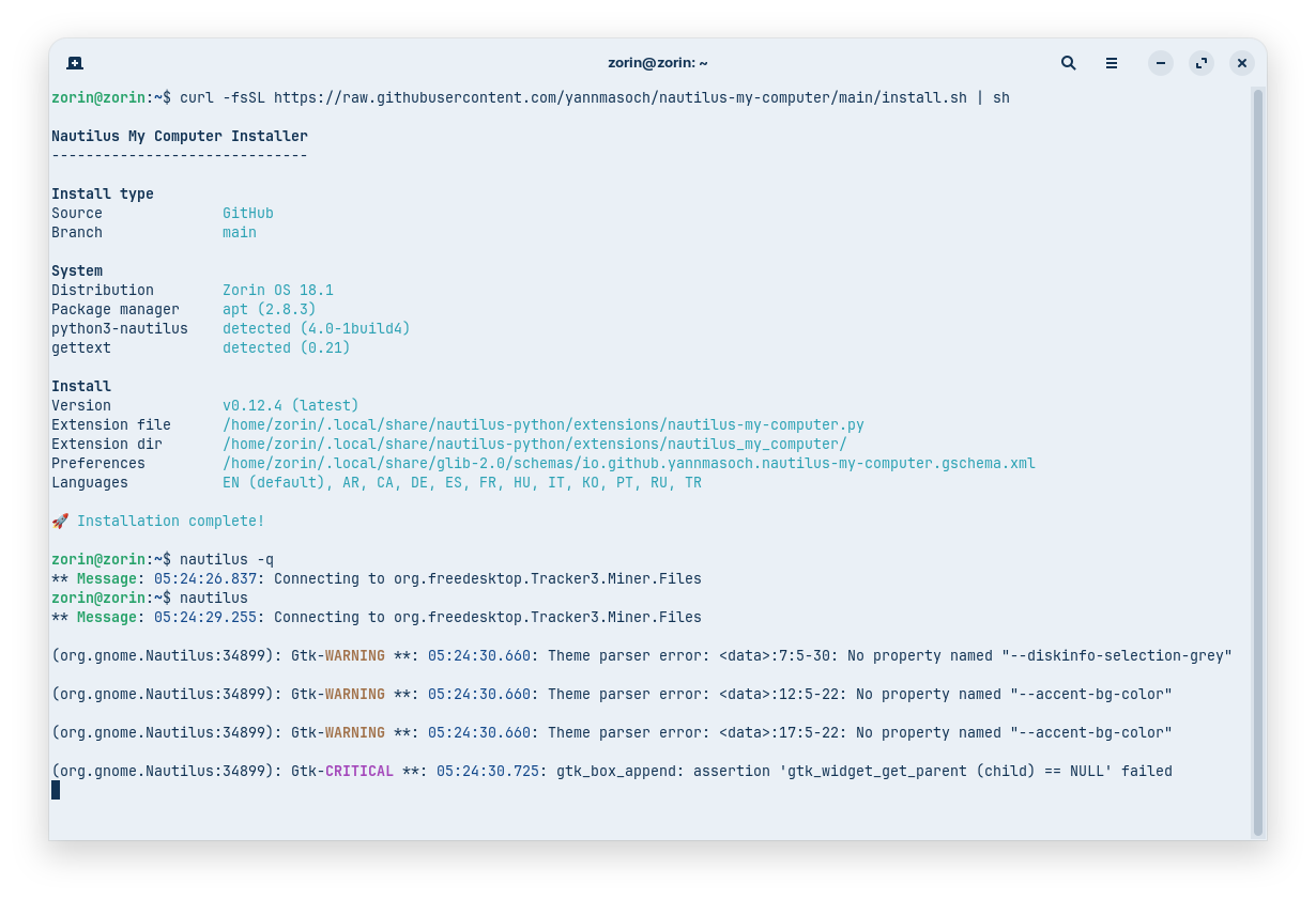

Hm, I had not saved the output, but I repeated the installation now, and this time there were no errors shown. Last time I had forgotten to disable my custom Zorin theme before with my edited .css files to change nautilus.
This was the terminal output now:
Perhaps I pressed a wrong key before, because when I wanted to call my history commands to choose the command for the installation again, there were hundreds of commands with just a single word of the installation script as if the installation script was splitted into parts. The installation was shown as successful at the first trial, too.
I'm very excited about the Miller Columns!!! I've been using Ranger, but it just isn't the same as what you get with Finder; and Pantheon just doesn't work right if you're not using elementary. I'm really hoping the development of this continues!
The critical line: Gtk-CRITICAL: gtk_box_append: assertion 'gtk_widget_get_parent (child) == NULL' failed. That is a classic case of widget-tree injection gone wrong. The code is trying to add a widget (gtk_box_append) to a Gtk.Box, but that widget already has a parent elsewhere in the tree—and GTK4 flatly refuses to allow a widget to have two parents. This implies the code expected Nautilus's internal structure to be in a specific state (an "orphan" widget ready for insertion).
I will not try with Zorin 18 for now till the extension would be stable on Gnome 46.
The extension looks promising, but I think it still needs to be tweaked to better support Ubuntu 24.04/GNOME 46.
This installed for me without error on Zorin OS 18.1 Pro. I think the install errors you saw may have been from trying to install on a "live" version of Zorin.

The problem with Gnome 46 is not the install read what I said, it c'ant work correctly with nautilus 46, it seem to work but it can crash at any moment

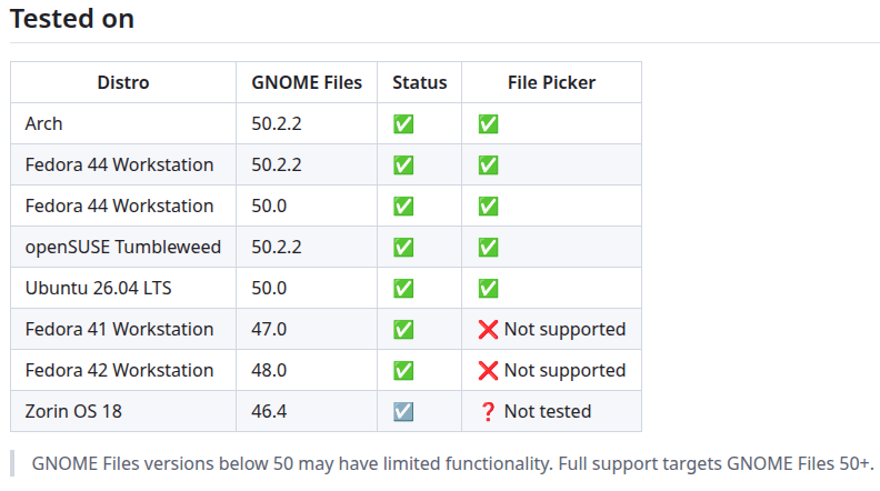

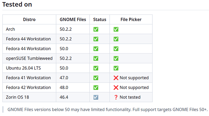

In the itsfoss Article is mentioned that it is for Nautilus in larter Versins because the ''Other Places'' Entry was removed. So, I would think it is intended to addresses more these later Versions.
There is also this Info on the Projects Github Page:
GNOME Files versions below 50 may have limited functionality. Full support targets GNOME Files 50+.
I had seen this and posted a screenshot of that message in the first post.
Well, this offers the Answer. It has the Focus on Nautilus 50.

I also get the impression that this extension works better than Pantheon, which I tried out a while back, and also better than the Directory menu plugin in XFCE, where you can't simply open files by double-clicking them.
I noticed a bug today, and I'd like to know if you're experiencing it as well:
When I click on "Computer" in the Nautilus sidebar, I can't scroll. As soon as I scroll, the Nautilus window closes. I always have to set the Nautilus to be maximized to see all of that window.
What does the error mean?
Gnome Nautilus is very sensitive and the API is not documented, bypassing some process is not a good thing to do. So it's unstable and it will stay unstable
