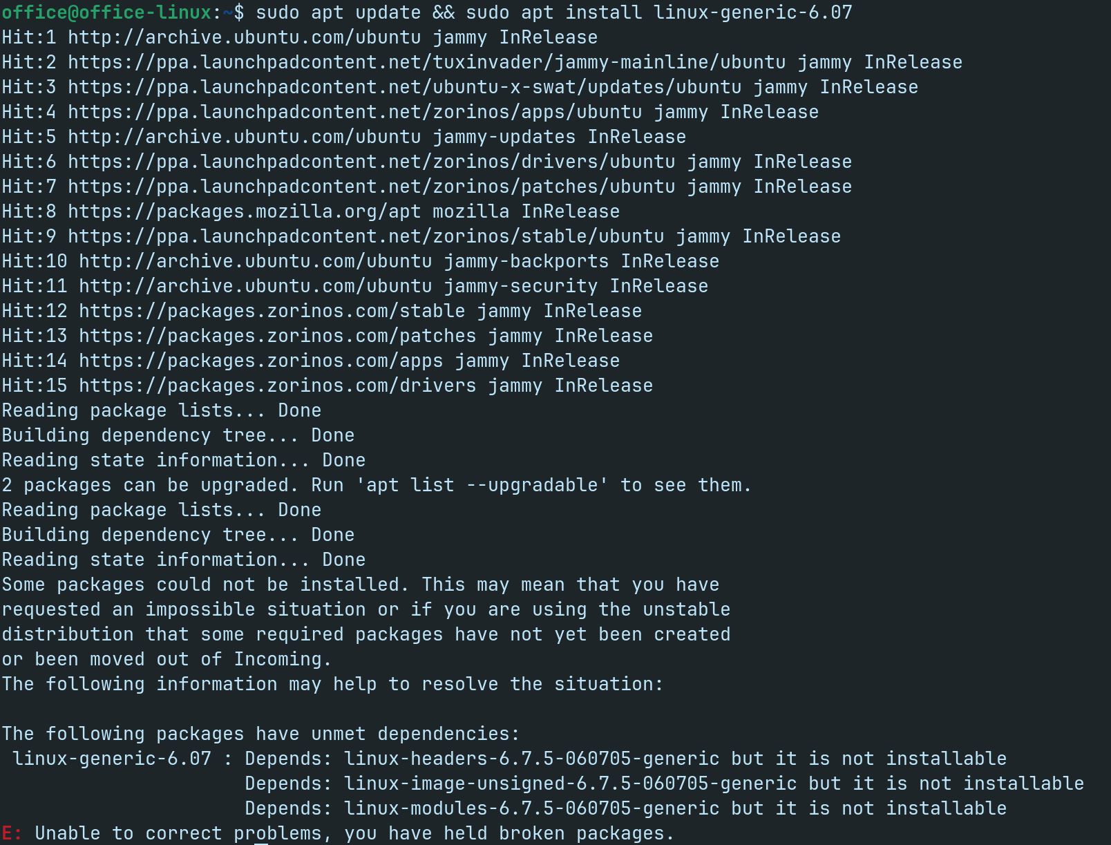

Seems it doesn't let me install the 6.7 kernel:
I just tested this and got the same result. I will report this bug to TuxInvader.
In the meantime, the 6.6.5 works
sudo apt install linux-generic-6.06

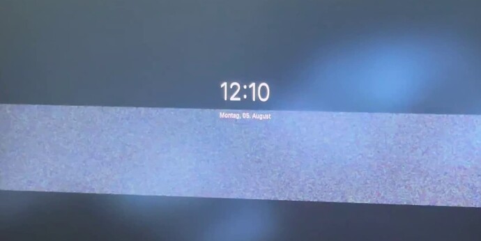

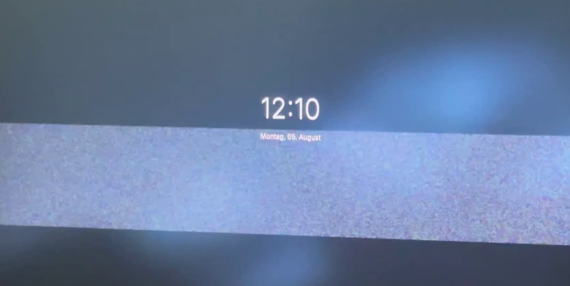

I am happy to announce that these kind of glitches
are gone after I changed the DisplayPort 1.2 cable to a DisplayPort 1.4 cable from the same manufacturer. Seems 1.2 may have problems with modern 165 Hz monitors.
The fullscreen bug though remains. I did not yet update the kernel because I first wanted to test the new cable.
