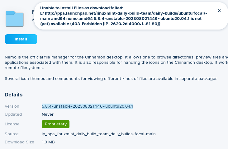

2.) I tried to install "5.8.4-unstable-202308021446~ubuntu20.04.1" using the software store, and i get this error,
Ah, Yes. This is exactly what was the Point: You add the linuxmint-daily-build-team PPA. That is the Reason why You had installed Nemo 5.8.4. But this PPA is for ubuntu focal - that is Ubuntu 20.04, the Base from Zorin 16. That will not work on Zorin 17 because it has Ubuntu 22.04 (jammy) as Base.

Hold on, before we continue, I need to say that I am using Zorin 16.3, not 17. Does that change any of what you advised?
Yes, that is important. Good, that you wrote it. So, theoretically it is the right Repo for the Zorin 16 Base. But it looks like that it doesn't run properly anymore. Maybe there have changed something on it.
What You could try first before You delete the PPA is that You take a Look in the List (what I describted) and take out the Marker:
After that make type in the Terminal sudo apt update and look if the PPA is no longer in the shown Source List. and then type apt list nemo -a to control what Nemo Version is available for You. Because when you are on an older Zorin Version the Nemo version could be older too.
