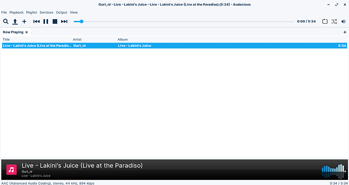

Do you get time info using audacious?

Yes. As you can see length of track is shown against each file.

Looking at the Music Library via audacious gives me this:
Sorry, I didnt know what you wanted me to show in regards to Audacious, here is what u asked, it does show duration, but my file managers dont.
And as I said, Dolphin doesnt load the duration, its empty.
