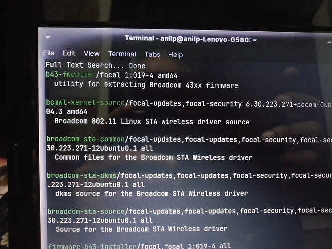

Have you checked to see if either bcmwl-kernel-source or broadcom-sta-common are installed? You can use apt list --installed but will show the full list of installed packages, make sure 'unlimited' scrolling is enabled in terminal first - or, apt search broadcom and will show you the list of packages pertaining to Broadcom. If you see either of the two packages above, it will have a [installed] flag in the description.
Don't feel bad at all - I was bashing my head against the wall trying to get an internal WiFi device working that was registering as a USB adapter Finally got it - but after a few concussions jk - don't bash anything..
If there's not a blacklisting for it - there has to be a driver butting-in and trying to take control..
Yes, they are listed as in pic above when I search for Broadcom.
I can't see " installed ", though.

I see the other drivers aren't installed - that's a good thing, b43 firmware is picky..
Copy and paste this: sudo apt install firmware-b43-installer b43-fwcutter and let that run - it will ask for your password, enter the pw and let it complete - reboot. That's the firmware for BCM43XX hardware - so far, that's the only way I've been getting BCM43 devices to even come alive.

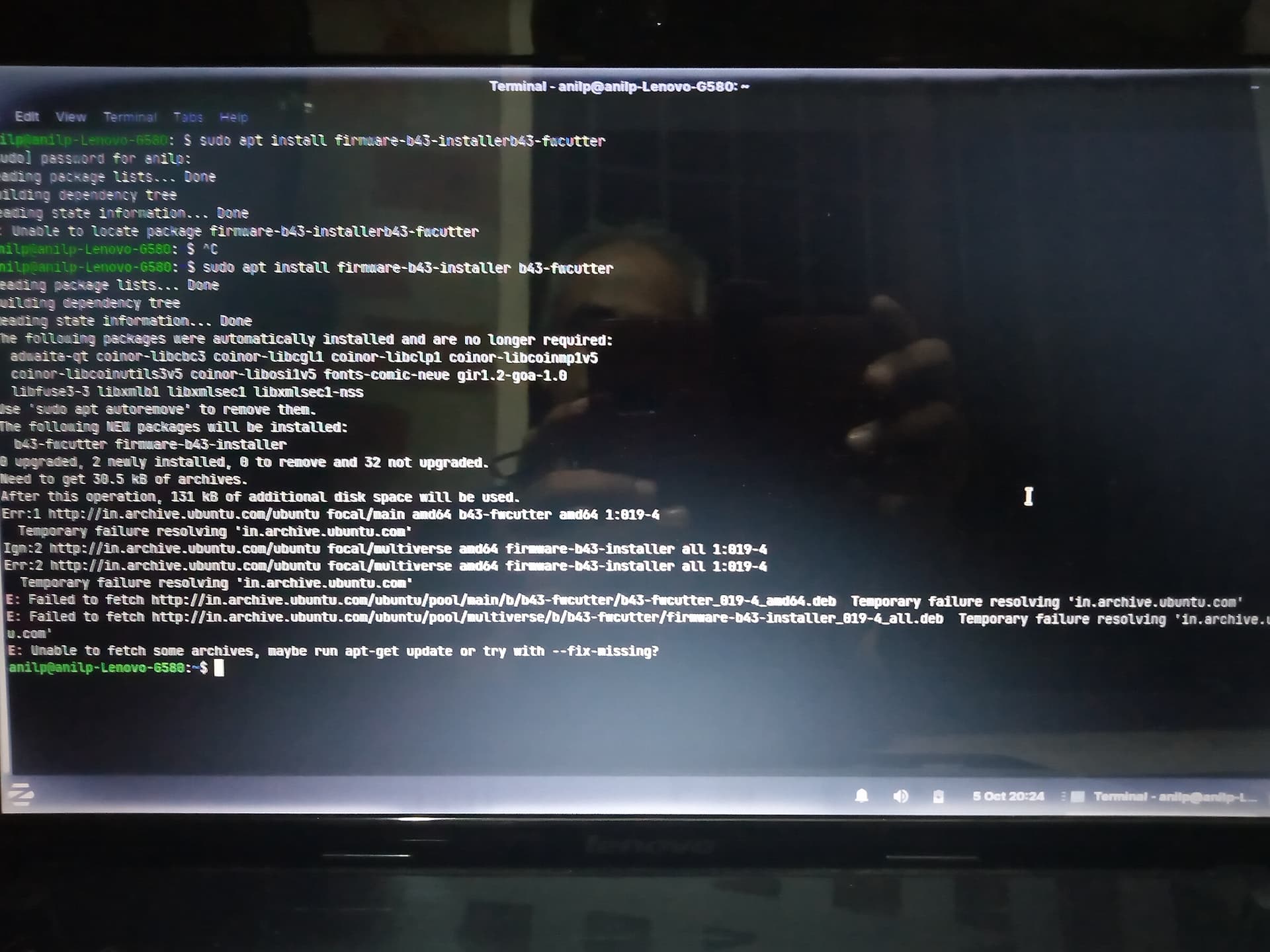

Okay so the last line that says how to fix: you can run sudo apt install -f or sudo apt install --fix-broken - both of those commands are the same, just depends on which one you want to type out, or copy / paste in this case heh. Also run sudo apt update --fix-missing
Don't get caught up too much with the blacklisting - with several devices using a BCM43XX adapters, none of them were blacklisted It just didn't install due to dependencies and lack of - the updates will fix that.
So - run sudo apt install -f / sudo apt install --fix-broken and sudo apt update --fix-missing, do a sudo apt update then sudo apt full-upgrade then sudo apt autoremove <-- need to watch that one, it may try to take things out that don't need to be removed, just pay attention to what's being removed - then sudo apt install firmware-b43-installer b43-fwcutter - reboot, and should be active..
Did all. There were messages that some archives could not be loaded etc etc.

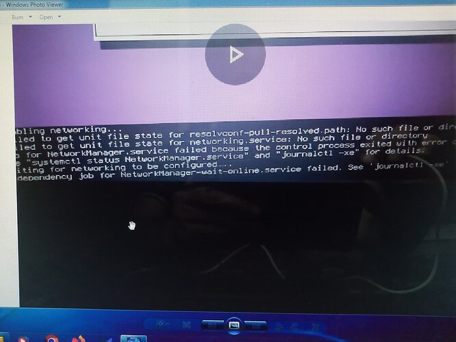

I went into boot-<-> F2 zorin advanced settings, selected zorin recovery mode. There the editing network enable function was there. When I click it, the message flashes and disappear. No way to understand. Again loading, my desktop is changed to old. But sudo lshw still shows network DISABLED .

But, before we get that far - it seems like there are some hangups in the system and possibly update repos. I would suggest taking a look into what @Aravisian pointed out about the temporary failure message; are you on the Main Server or, pointing to a different source?
His screenshot shows the India regional server and that it says "temporary" implies that a known outage is at fault. Switching to Main Server, running sudo apt update && sudo apt full-upgrade may help; then reverting back to the regional server in a day or so to keep the Main Server from being too bogged down.
Regional Servers with a lot of traffic can experience more delays.
