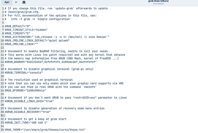

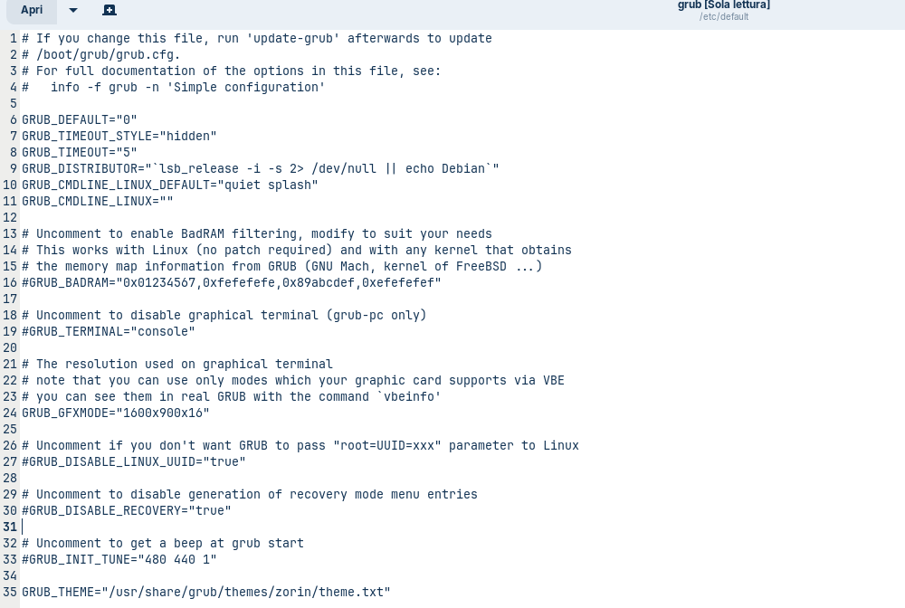

It shows an Error in the grub File. Can You check the File in /etc/default/grub and post the Content of it here?

GRUB_DEFAULT="0"
GRUB_TIMEOUT_STYLE="hidden"
GRUB_TIMEOUT="5"
GRUB_DISTRIBUTOR="lsb_release -i -s 2> /dev/null || echo Debian"
GRUB_CMDLINE_LINUX=""
Uncomment to enable BadRAM filtering, modify to suit your needs
This works with Linux (no patch required) and with any kernel that obtains
the memory map information from GRUB (GNU Mach, kernel of FreeBSD ...)
#GRUB_BADRAM="0x01234567,0xfefefefe,0x89abcdef,0xefefefef"
Uncomment to disable graphical terminal (grub-pc only)
#GRUB_TERMINAL="console"
The resolution used on graphical terminal
note that you can use only modes which your graphic card supports via VBE
you can see them in real GRUB with the command `vbeinfo'
GRUB_GFXMODE="1600x900x16"
Uncomment if you don't want GRUB to pass "root=UUID=xxx" parameter to Linux
#GRUB_DISABLE_LINUX_UUID="true"
Uncomment to disable generation of recovery mode menu entries
#GRUB_DISABLE_RECOVERY="true"
Uncomment to get a beep at grub start
#GRUB_INIT_TUNE="480 440 1"
GRUB_THEME="/usr/share/grub/themes/zorin/theme.txt"
This is the Zorin OS grub file.

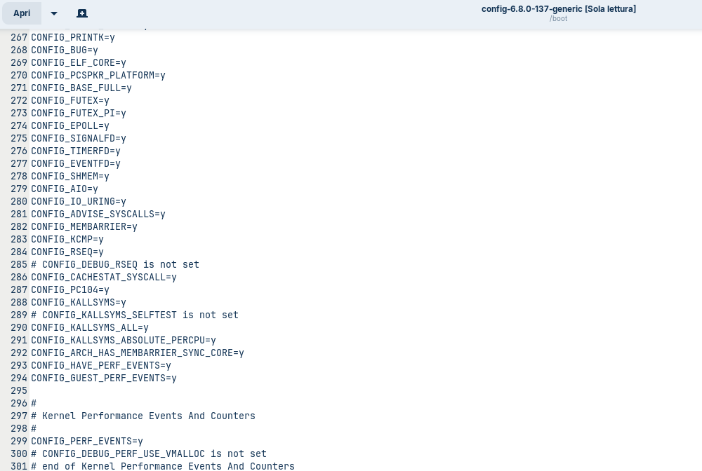

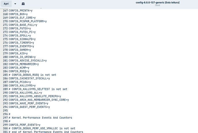

this is the "boot" file of kernel 137, still in Zorin, if it's of interest:

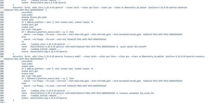

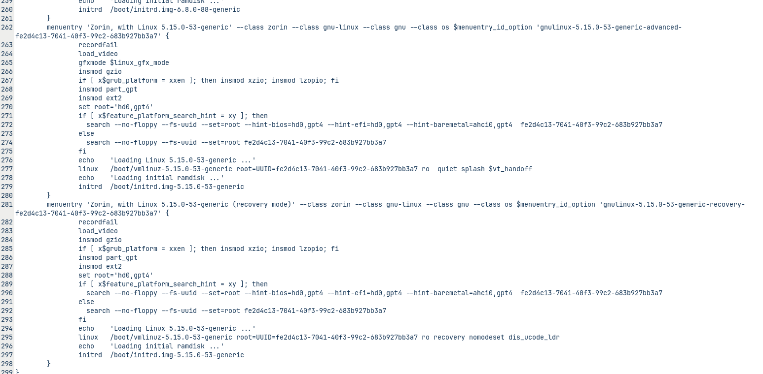

Okay, then we have to check a different File. Open the File /boot/grub/grub.cfg but for this new You use the Text Edior, You will have to type in Your Password to get it shown.
this is it: /boot/grub/grub.cfg with gedit
The file is too long to copy the entire thing. Should I just include part of line 286?
