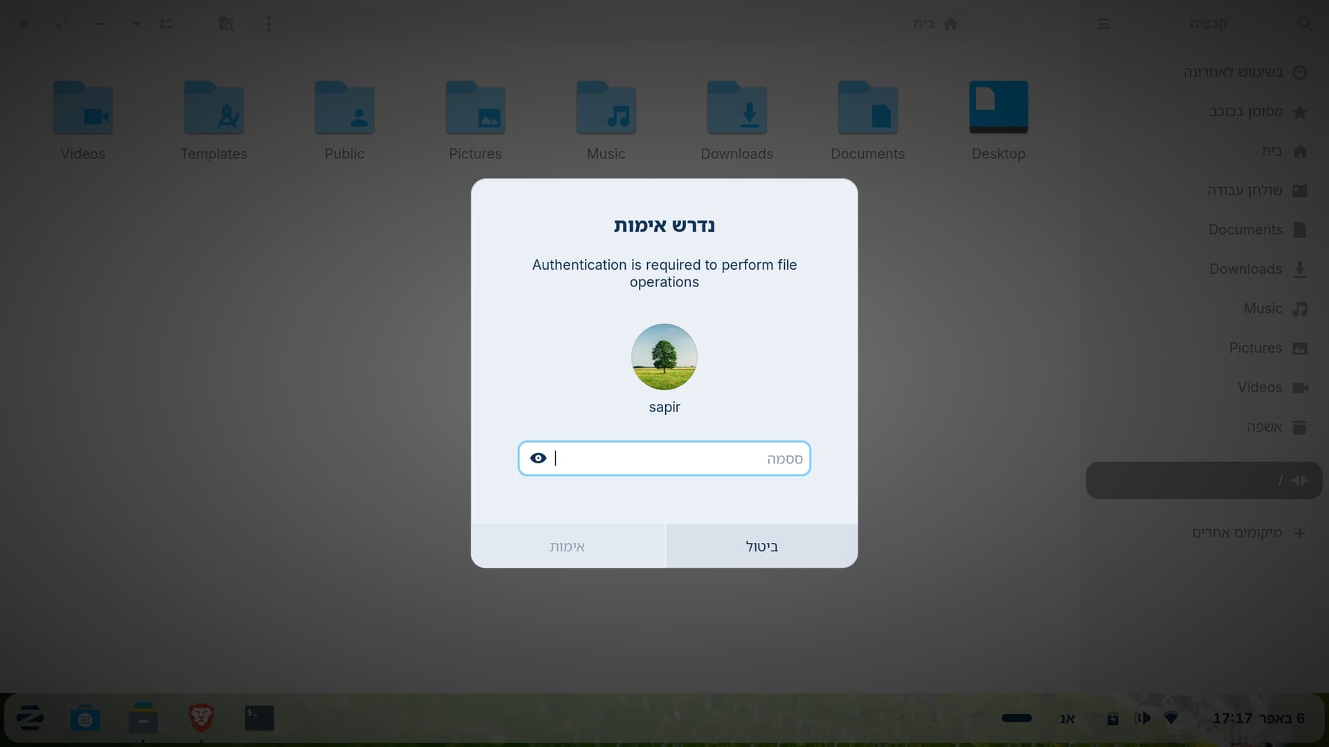

New user- have problem with gnome-keyring seahorse: keeps asking for password after logging in
Hi,
I am a beginner (14+- days of use). this is my 2th attempt at the os, first time I used AI's help till it crashed everything.
In both attempts I have this problem: some app keeps asking for password whatever I do. when I open the root folder (not in terminal), when I use the internet, when I open other folders or files and so on. I can put in 5 mints my password more then 4 times. I am so sad and frustrated.
I have a password that I put when I enter the user and it's the same as the gnome-keyring's password. (so it sould have been fine). I also have keepass that connects to the browser (brave).
In my second attempt I tried to learn more from the internet the from AI. I searched 2 days and used AI to try find a salutation and I didn't.
I don't want to comprise my security by using a blank password. I tried many thing that the AI asked and probably hurt my os.
would appreciate help with the problem itself and with restoring any damage I might did :folded_hands:

What is seen on your end:
You have:
  1. Only one keyring named Login :check_mark: (this is good)
  2. Inside it items like:
  • Brave Safe Storage
  • Chrome Safe Storage Control​:backhand_index_pointing_right: These are not additional keyrings β€” these are simply items/tokens that applications save inside the keyring.:light_bulb: Meaning: You do not have a "multiple keyrings" problem.So my previous hypothesis was not correct in your case β€” let's move forward.
So what IS the problem?
What is seen in the photo:
:locked: Next to each item there is a lock β†’ this means that the keyring is currently locked.
:backhand_index_pointing_right: And this is the matter:
Even if it "opens sometimes," it probably locks again too quickly / does not open in the session as it should.
The right direction now (this is the key):
There is a very common situation where:
:backhand_index_pointing_right: The keyring DOES open in the login.
:backhand_index_pointing_right: But the environment (session) does not "remember" it.
:backhand_index_pointing_right: And then every application asks again.
This happens when environment variables are not loaded correctly.

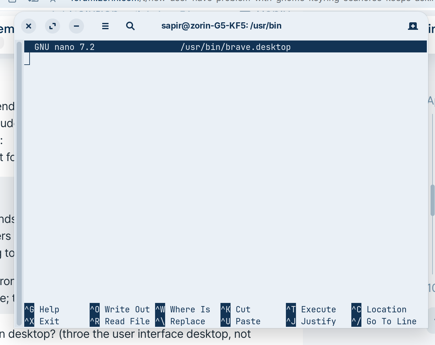

sapir@zorin-G5-KF5:~$ sudo gedit /usr/bin/brave.desktop
[sudo] password for sapir:
sudo: gedit: command not found

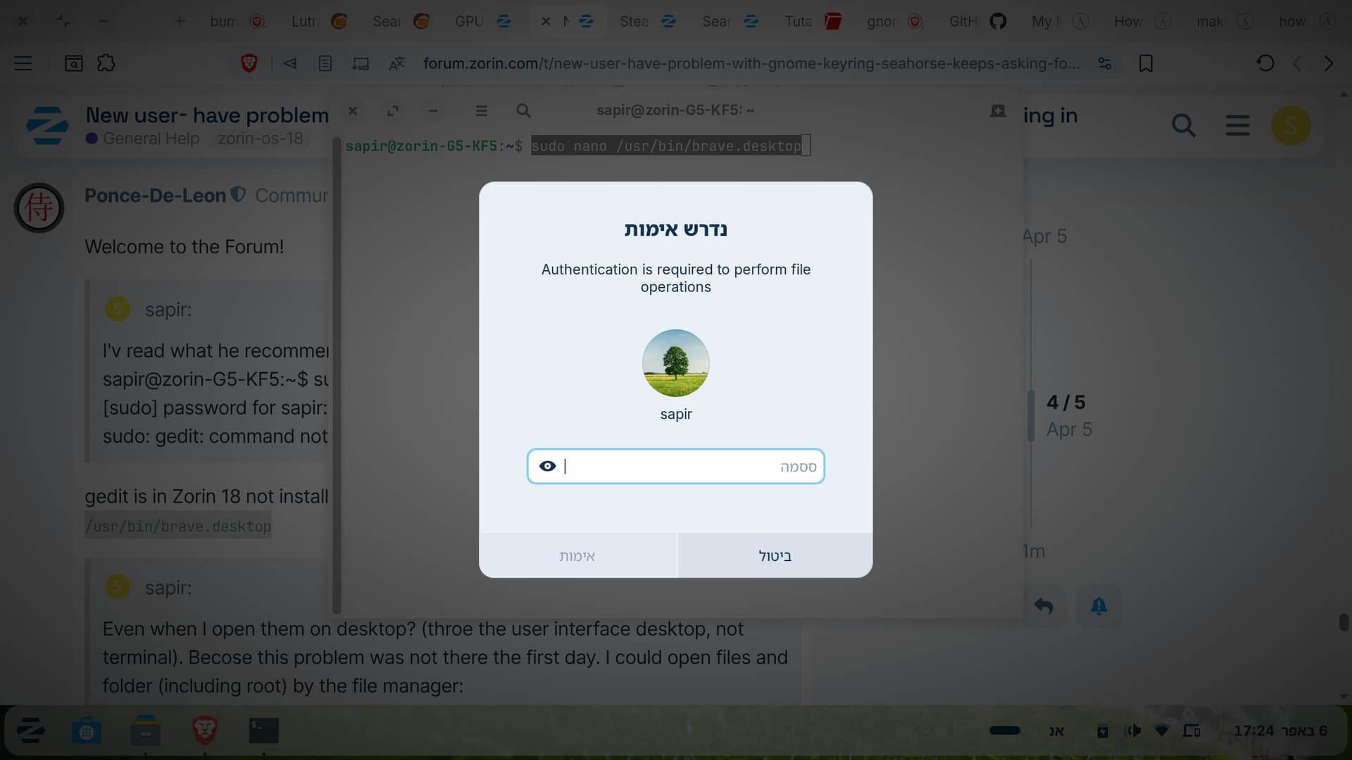

Even when I open them on desktop? (throe the user interface desktop, not terminal). Becose this problem was not there the first day. I could open files and folder (including root) by the file manager:
gedit is in Zorin 18 not installed be default. Try instead sudo nano /usr/bin/brave.desktop
Could You post some Pictures of these Password Prompts please?
Sure,
In this example I tried to open the "/" folder. It is the most controlled way for me to cause this pop-up but it repeats itself randomly when I'm on the web and playing (throe lutris).

I tried the command, it worked but the file looks ampty. It happened before so I tried to so the command from the folder bin and it opened empty
The / is top level Root directory. It will always ask to be authenticated on first opening.
If you authenticate, then close the window, you have a few minutes grace period to relaunch before it will popup to authenticate again.
It should be:
sudo nano /usr/share/applications/braver-browser.desktop
In that guide, I believe the O.P. was referencing Google-Chrome browser that was installed directly in the etc directory.
