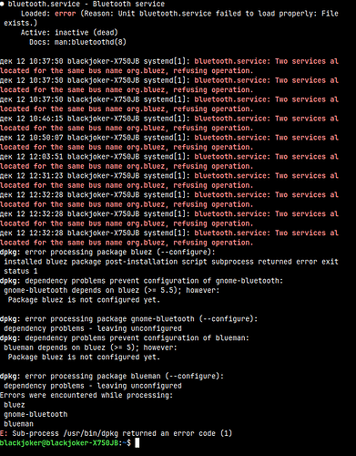

When I'm making 1. Install build dependencies:
I got this message

@swarfendor437 I changer server to main then I got this
It looks like there is a fault in GDM and bluetooth being registered to run on two separate instances of it.
Have you at any point tried
Or have you ever tried replacing GDM with SDDM or LightDM but GDM was left unconfigured?
