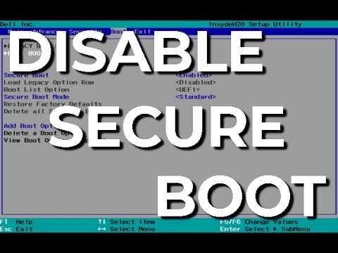

The method to get into your system BIOS, differs from manufacture. From computer off state, press power button to boot computer. Immediately and repeatedly rapid press, one of the following keys, to enter the BIOS. If one key doesn't work, try another, until your in the system BIOS.
F2, DEL (Delete), and F10,
or, F1, F12, or Esc.
Watch a YouTube video if you need more guidance...
"Secure Boot" is located in the "boot" or "security" section of your system "BIOS."
Picture taken from the net.
