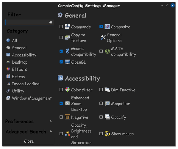

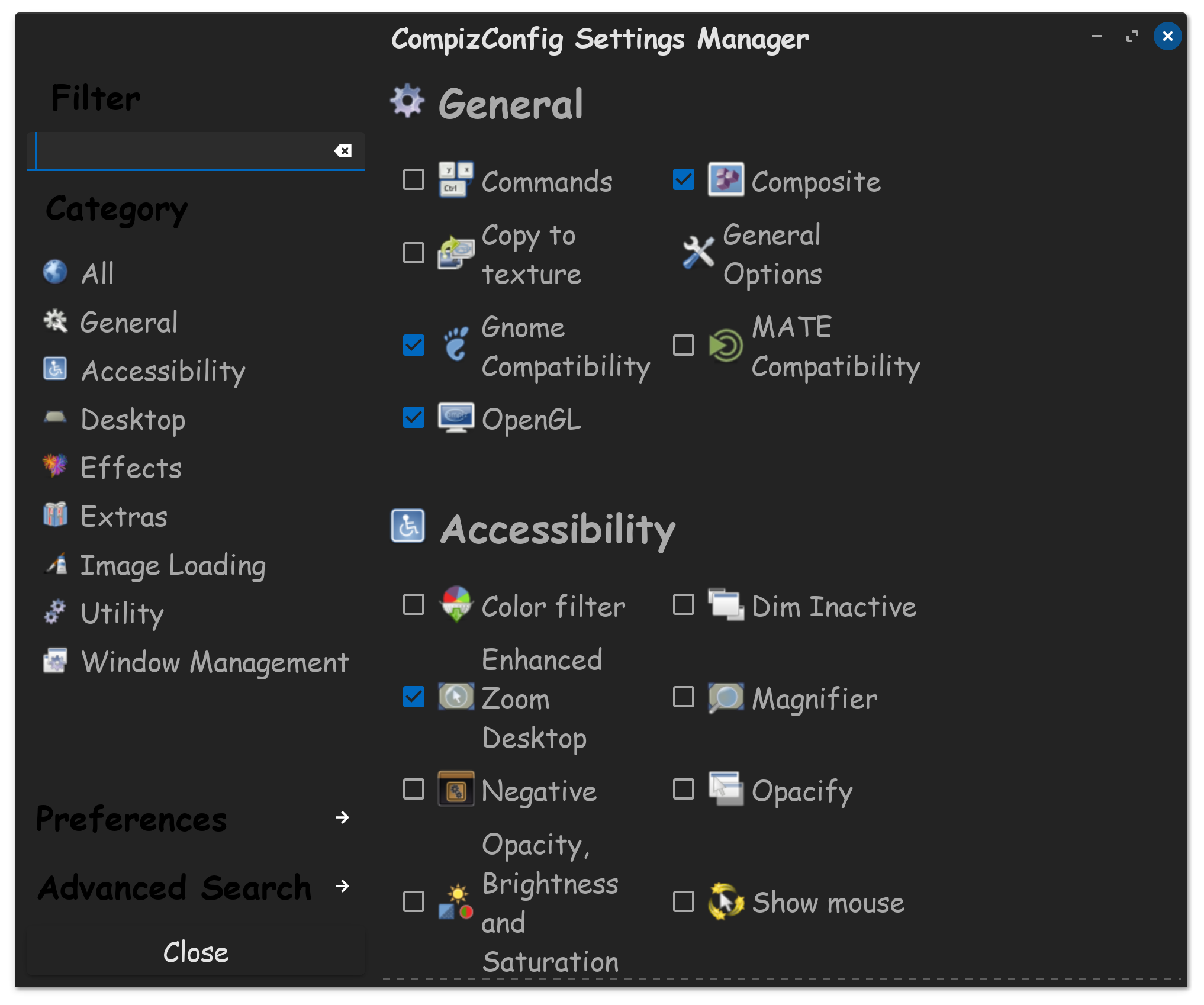

If I understand correctly, you are not able to adjust your refresh rate, both in Displays & Nvidia X Server Settings...
If this is the case, please try the following bellow please...
(Install Compiz)
Launch Compiz & click on "Composite."
Uncheck "Detect Refresh Rate," now, attempt to set your refresh rate in the "Refresh Rate" box right...
