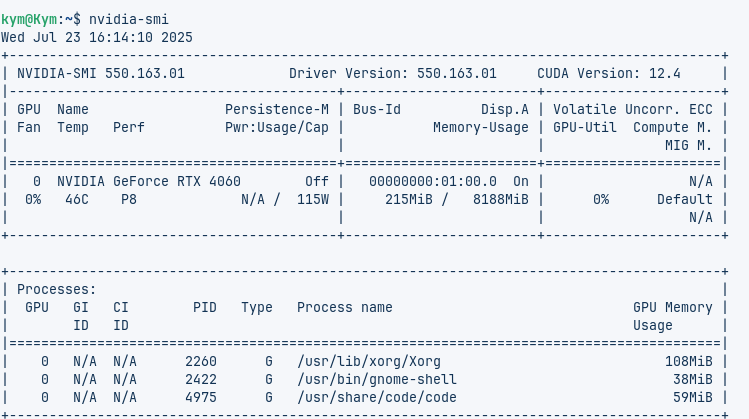

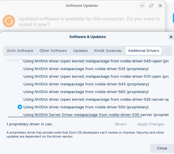

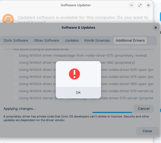

I was using nvidia 550 drivers and it was working, I can play games in good fps, using rtx 4060. But when I try to install nvidia 570 drivers. I got "out of range error" then I boot it with live usb and removed the drivers, then reinstalled the 550 drivers. I can play my games again but after 2 months I tried again, cause I thought it was about zorin os and update could solve it. But it didn't. I reinstalled nvidia 550 again but now I can't play games. It says no gpu detected
