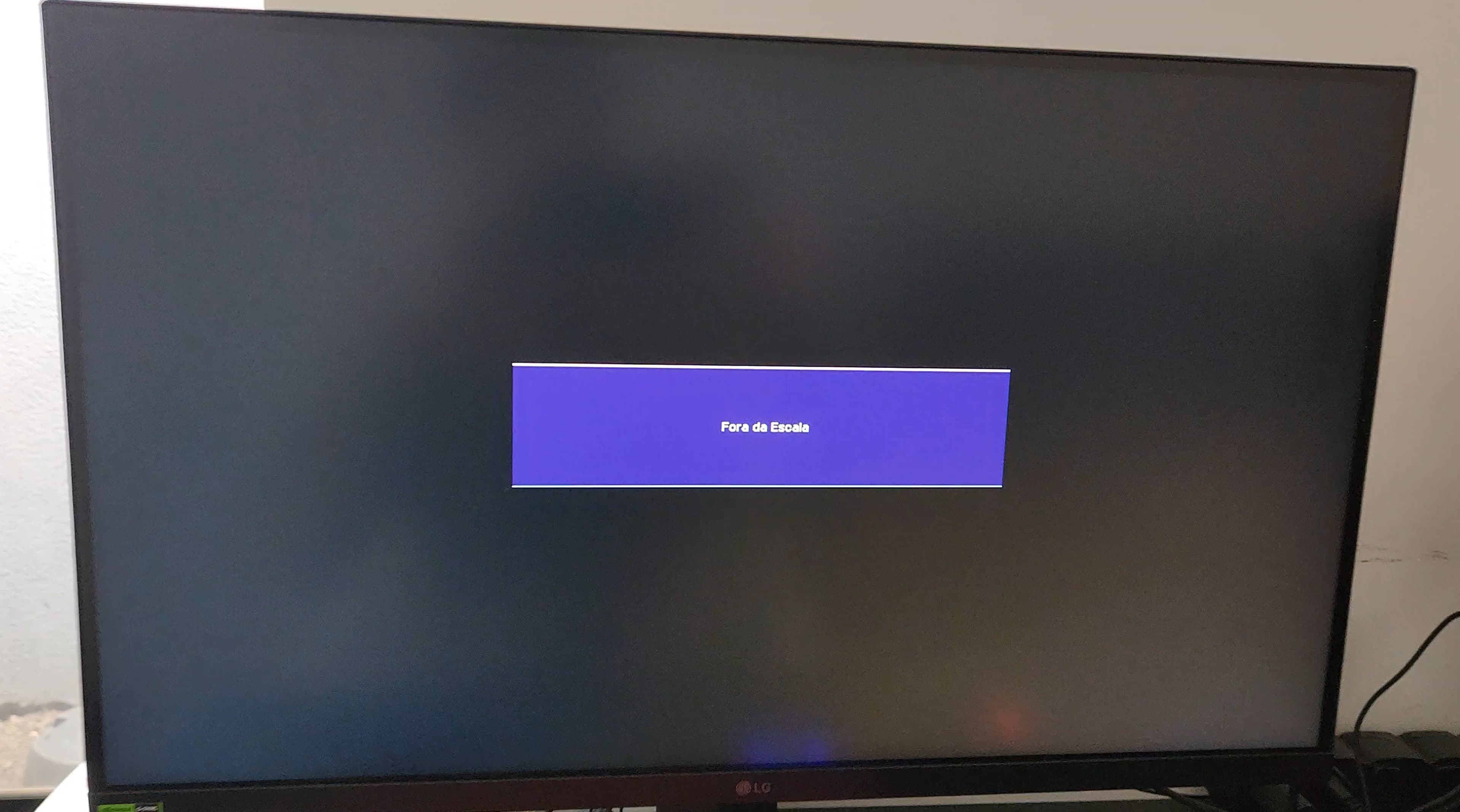

Zorin Os won't start, "Out of Scale"
I installed Zorin OS normally using an Nvidia driver option. After installation, it restarts like any other operating system and, upon starting, the monitor screen goes black with "Out of Scale" written in the center of the screen.
NOTE: I have tried it without the Nvidia drivers and had the same problem..
Monitor LG 27" FULL HD 144hz
RTX 4060
That message on the screen is displayed by your monitor, not by Zorin OS. So this means your monitor is not supporting or accepting the screen resolution or refresh rate being output.
Normally, I would suggest trying the things you have already tried, such as Safe Graphics or Changing graphics drivers.
Can you go through the settings on your monitor (Accessible by buttons on the monitor itself) and see if you can adjust its range?

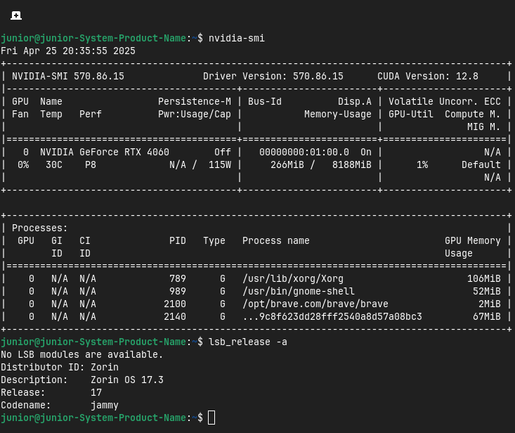

A friend sent it to me to do it. If it works, return here. "install the Nvidia 570 driver, and before rebooting, add the parameter "nvidia-modeset.hdmi_deepcolor=0" to the end of the parameter line in the /etc/default/grub file. After that, run the command "sudo grub2-mkconfig" to apply the parameter on the next boot, and reboot. There are some random memory problems that cause this error, but what seems to be most common is the fact that the Nvidia driver comes with DeepColor mode enabled by default and some monitors are not compatible. I discovered this recently and have already reported it to Nvidia."
i installed the Nvidia driver 570, and before restarting, add the parameter "nvidia-modeset.hdmi_deepcolor=0" at the end of the parameter line of the file /etc/default/grub. After that, run the command "sudo grub2-mkconfig" to apply the parameter on the next boot, and restart.
Brilliant. Thanks for sharing this and returning with the update and additional information.
