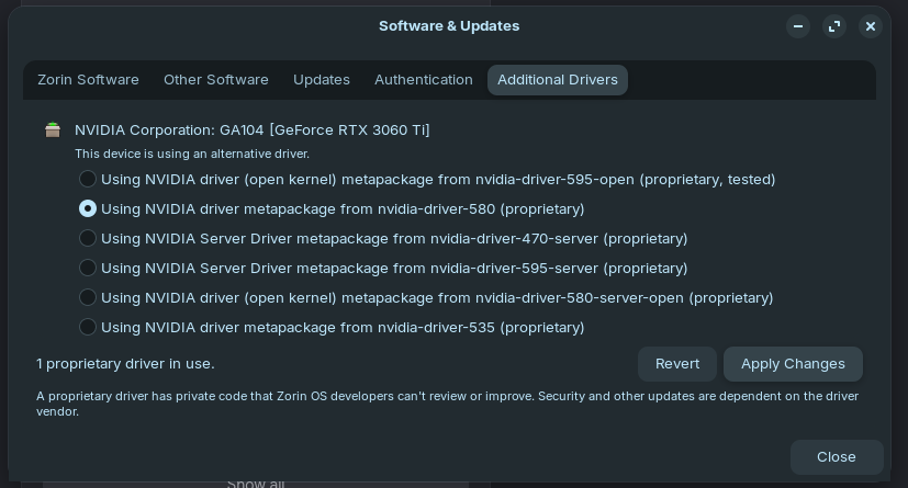

NVidia Drivers vanished
...and...
Yes! It worked! All back to normal now. :smiley: Thanks everyone!
Switching to XORG and updating the Graphics drivers appears to have worked in my case - Ubuntu Canonical must have been fixed.
No, they aren't. When one of them would be installed, You would have stand at the End [installed]
I have been using this system for quite a long time, since October 2025, but as practice has shown, Zorin was updated from 18 to 18.1 and some packages began to be displayed without keys, even when they are present, the system looks for them in another place, I figured it out well and here is how I fixed it, package signatures.

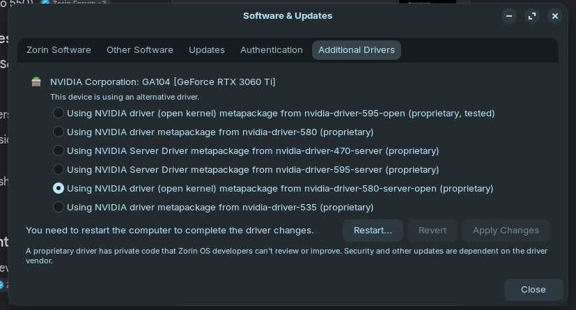

Either disable secure boot or make sure the Secure Boot Keys are enrolled in the MOK. Here is a way to test if they are:
scott@scott-Falcon-Talon:~$ sudo mokutil --test-key /var/lib/shim-signed/mok/MOK.der
[sudo] password for scott:
/var/lib/shim-signed/mok/MOK.der is already enrolled

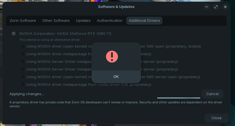

it sees updates for 595 and considers them as for my 590 driver.
although when updating it screams that I have 590, I can't put 595 on top of it, which is still in beta and completely unstable.
so in the end I get the answer that I have broken packages.
The packages are not actually broken, there is actually a problem on the servers: the package for the 590 driver mistakenly refers to the 595.

As such I'm going to use the 'additional drivers' tab in 'software and updates' like this:
Which it didn't like - I got this error message:
After which Software and Updates told me that no proprietary drivers were being used, and the radio button for 580 wasn't selected.
It seems happy with this arrangement however:
Ok - not only did that not work - Zorin can't connect to the internet either. I've had to boot up into Windows now.
