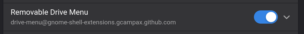

Okay, maybe it is the Gnome Extension. Open Gnome Software and search for ''Exension Manager''. It is this one:
Install it, open it and go to the ''Installed'' Tab. Look there for the Extension ''Removable Drive Menu'':
Turn off the Toggle. That will deactivate it. Make a Reboot and then active it again and test if it works.

I would suggest to reinstall it but I didn't found the Package ...
@Ponce-De-Leon You could look if it is here (found on a post of 2021):
usr/share/gnome-shell/extensions
and there
drive-menu@gnome-shell-extensions
