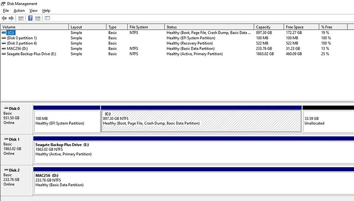

This is what my disk status looks like in Windows. I'm fairly sure the unallocated 33.59 GB represents my attempted (successful?) partition during my failed installs, but I don't understand why it doesn't show up in the volume listing.
Windows works fine, so I don't think I damaged the Windows partition.
We’ll that’s a relief that windows still works as it should.
You can try installing Zorin to the unallocated partition using the something else option. You should reformat it to ext4 and use / as the mount point. You can do all that through the something else option Use the + button. Point the boot loader at the efi partition.
