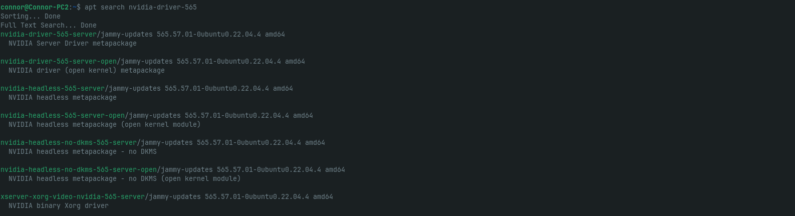

apt search nvidia-driver
and look to see which versions are listed. You will see a long list... So only focus on the ones that format as "nvidia-driver-5XX"

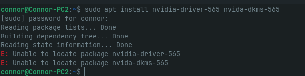

So running the search provided a large list as you stated, we found the 565 driver so we further restricted the searched based off what we found and got this. I have switched from Wayland to Xorg, do I install the nVidia driver or the Xorg nVidia driver?

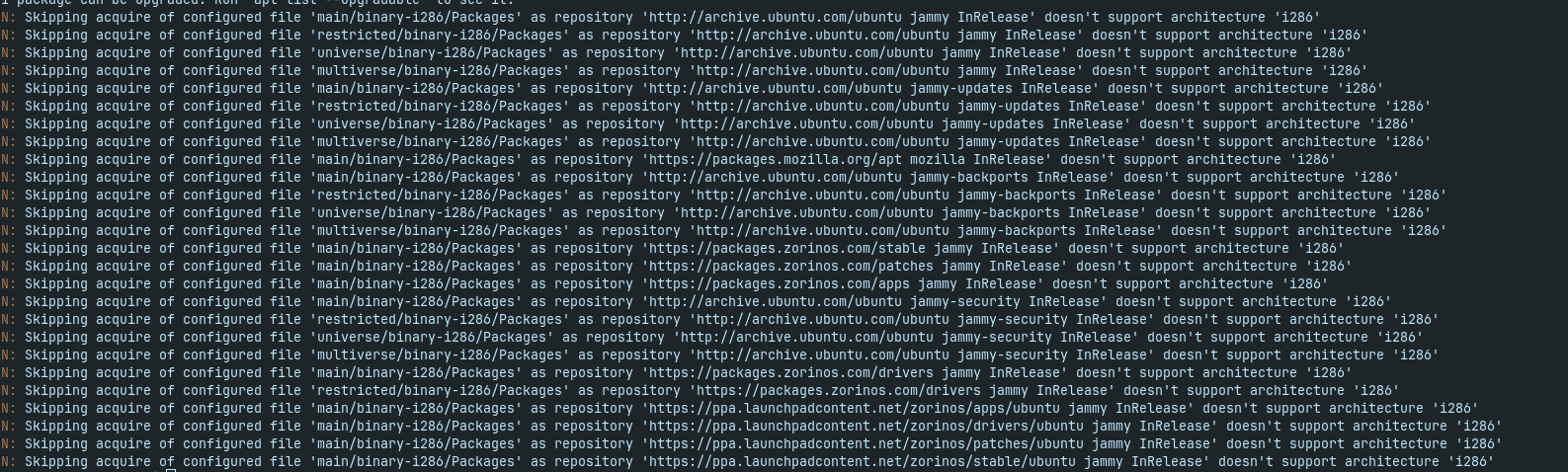

Also when we ran sudo apt update we got this, could this be the cause of any of our freezing problem?
Using
sudo apt install nvidia-driver565 nvidia-dkms-565
Really should work...
But it is possible that the automated ubuntu-drivers-common package recognizes a specific conflict between your card and that driver; in which case, do not force it.

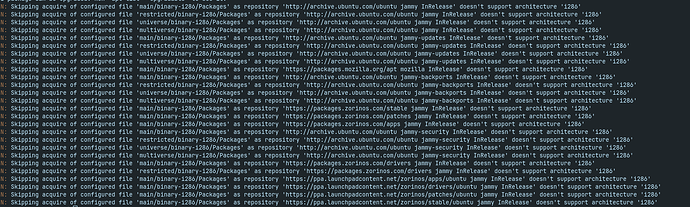

i286? What?
What does the terminal produce for
dpkg --print-foreign-architectures
We'll try the drivers listed tomorrow, the print command returned 1386 and 1286 in that order
Well, i286 is... quite old. That would be the 80286 released by intel in the early 1980's.
I must assume that either a typo was involved when adding 32bit arch support or... at some point you were looking for 16 bit support?
You can remove it with
sudo dpkg --remove-architecture i286
I am not personally aware of any modern 80286 16bit support in GnuLinux, though it may well be present in BSD and other sources of Linux.

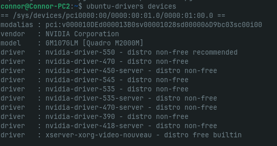

You can check for compatible drivers using
ubuntu-drivers devices

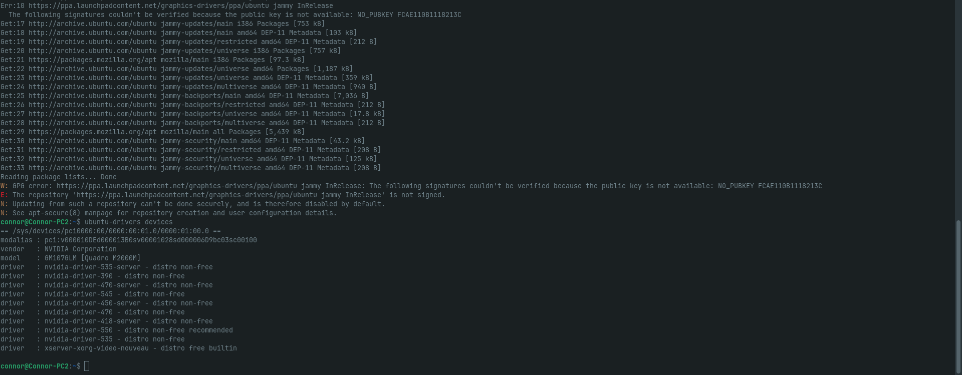

Aravisian, your commands were ran but to my understanding we appear to have an error on the update command. Running the devices command returned the 470 driver you mentioned and another XORG driver.
Here is the repository:
I can only suspect that something went wrong with the keyring, due to the Ubuntu Graphics Driver most definitely being signed - in fact, it has to be signed in order to be uploaded into Launchpad and accepted.
Let's try correcting it.
Remove the repo first:
sudo add-apt-repository --remove ppa:graphics-drivers/ppa
Ensure the keyring is properly added while adding the repository with this more complicated command:
echo "deb [signed-by=/etc/apt/keyrings/graphics-drivers.gpg] http://ppa.launchpad.net/graphics-drivers/ppa/ubuntu $(lsb_release -cs) main" | sudo tee /etc/apt/sources.list.d/graphics-drivers.list

Aravisian, it appears we no longer has errors with your latest commands, I'm just still unsure of which driver we need to install?
The command
sudo apt install nvidia-driver-550 nvidia-dkms-550
should work, based on your list.
It shows the 550 proprietary as 'recommended.'
