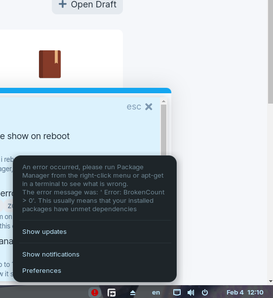

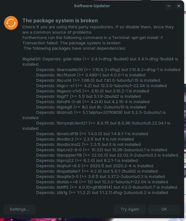

Package system is broken after upgrading
Hello guys, I got this error after upgrading to zorin 17. The OS is now working i think, but when I try to do software update it show this
There is also this
Can anyone help?

dpkg: dependency problems prevent configuration of libgdal30:
 libgdal30 depends on libodbc2 (>= 2.3.1); however:
  Package libodbc2:amd64 is not installed.
 libgdal30 depends on libodbcinst2 (>= 2.3.1); however:
  Package libodbcinst2:amd64 is not installed.
dpkg: error processing package libgdal30 (--configure):
 dependency problems - leaving unconfigured

The following packages have unmet dependencies:
 libgdal30 : Depends: libodbc2 (>= 2.3.1) but it is not installed
             Depends: libodbcinst2 (>= 2.3.1) but it is not installed
E: Unmet dependencies. Try 'apt --fix-broken install' with no packages (or specify a solution).
earl@Shiron:~$ sudo apt remove --purge kdeconnect
Reading package lists... Done
You might want to run 'apt --fix-broken install' to correct these.
 libgdal30 : Depends: libodbc2 (>= 2.3.1) but it is not going to be installed
             Depends: libodbcinst2 (>= 2.3.1) but it is not going to be installed

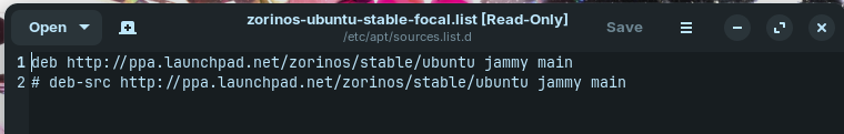

so in my case which ones should I remove from /etc/apt/sources.list.d ?
Can you navigate to /etc/apt/sources.list.d and right click on the files and see if the content within them points to Focal or Jammy?
You do not need to elevate to Root Privileges since you are reading only.
the file name focal but the content is jammy?
something like this
As long as the content within says Jammy, it should be fine.
This was confirmed earlier in a message from the ZorinGroup when I directly asked about this issue. The upgrader changes the content within the file which is the Source.
Does the command
sudo apt --fix-broken install
try to remove the broken package, try to install the broken package or end in an error?
There is this 2 but it is commented out.
Screenshot from 2024-02-11 10-11-33
the rest are all jammy
