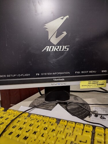

There ya go: F12
How do I navigate to my Boot Order in BIOS? So it is hung on part of dual boot menu.
When you reboot, what happens when you mash the F12 key?
So F12 sends it to Boot Menu? Anyway it has no effect pushing F12 while it is trying to boot finally try's to reboot again about two more trys then shuts down. Is there a special way to do this?
It may be a timing issue. F12 should send you to the boot menu from the motherboard splash screen. But you need to hit it pretty quickly before the computer initializes the boot sequence.
It doesn't do anything, there is the problem. The old dual boot menu is mess up. How can we tell it to only use Zorin?
Can you try F8 instead of F12?
That is dead also or has no effects.
How about spamming f2 or delete while starting ? Like Aravisian said, it's a matter of timing, and modern drives have made it a very, very short time that you can hit it.
That being said, if you get to that blue screen, when it says hit escape to go to UEFI, does it bring you there?
Hard to be sure but I think the f keys keeps the screen black longer or shorter period of time seeing the motherboard booting screen. Escape has no effect and also the End key.
Is there a potential for your keyboard to be having some issues at the same time? Could you also try plugging it into another USB port on the computer to make sure the port isn't bad as well?
The fact that it's bringing up nothing at the bios screen is very weird. Another option that could be tried is to take out the hard drive entirely so there's nothing it can boot from so you can see if you can get in the bios then.
I just now found that the keyboard I was using is bad. Now pushing F12 I can get into Motherboard boot menu. All the other keys are also working.
Now the problem is a corrupted boot file on the SSG. Looks like everything else is set properly.
