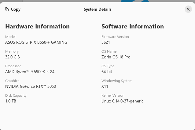

Morning all I did and upgrade from 17.3 pro to 18 pro using the test server and would like to report a sucsessful upgrade ill post a screen shoot of my system i have
I did have to use terminal to force the test server to show in upgrade area
oh i almost forgot i did upgrade kernel on 17.3 pro to 6.12 from tuxinvader as well as jumping from 6.8 to 6.14 may be abit of a streach
