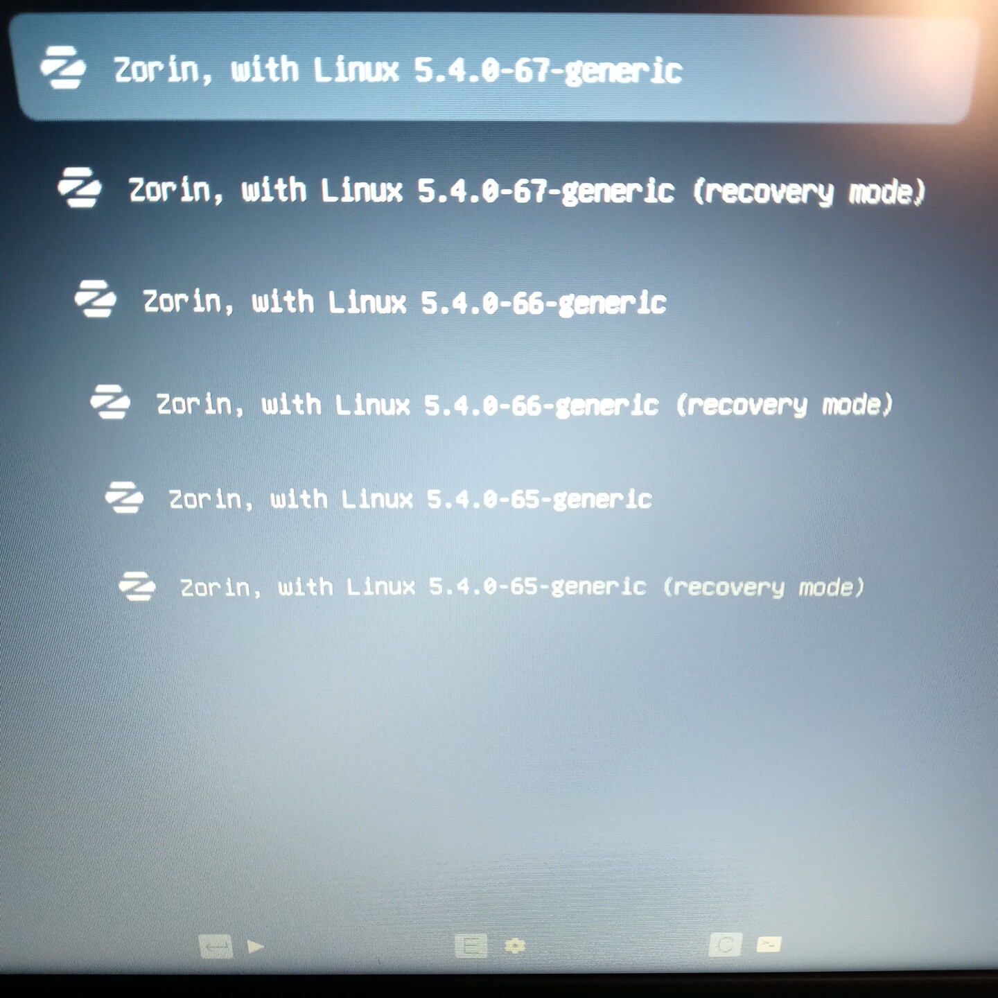

I restarted the computer and held down the left shift key and chose "Advanced Options", but now I'm not sure which of these to choose.
You can try the first listed (Recovery Mode) kernel.
I chose that one, and this happened. What now?
That screen says to run fsck manually. It looks like the Second Option I listed up above is the only option.
