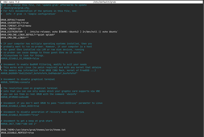

Can you please post a screenshot of the content of the /etc/default/grub file?
Nope, I have only Zorin and until now i never even used grub
Hm, to me the file looks right. Check if you are running the old kernel before you edit that file and update grub.

Another case which may cause problems: Have you installed and used the app "grub customizer"?
Boot in the older Kernel and then open the Terminal and type sudo update-grub and then reboot to check if it works. And please post the Output of the Command.
I'm now using the "7.0.0-28-generic" version, which is the one that works
Okay, You booted in Kernel 7.0.0-28 and made the sudo update-grub, right? The Output looks fine for me. Does it work now or does it still boot in the wrong Kernel?
Yes, it still boots in the wrong kernel if i don't select it manually in the advanced options
