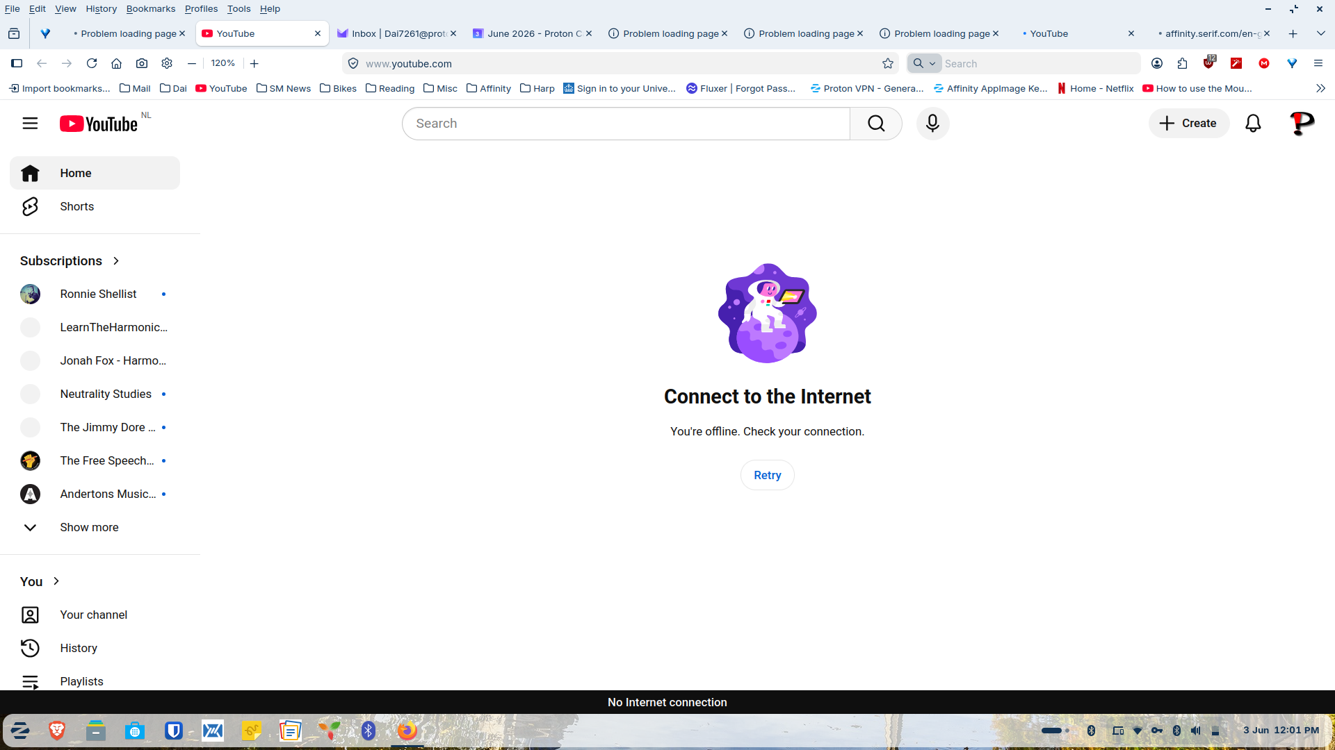

Can only connect to the internet when ProtonVPN is running. If it's not running both browsers won't work. Anyone know what the cure is. Browser should work with or without proton VPN. Default browser is FireFox.

It looks to me like the kill switch is turned off. So I think the problem lies elsewhere.
Did all that tested with no vpn active only pages that worked were proton mail and calendar all other pages could not load until vpn turned on again. also did a restart before I did all this just in case.
