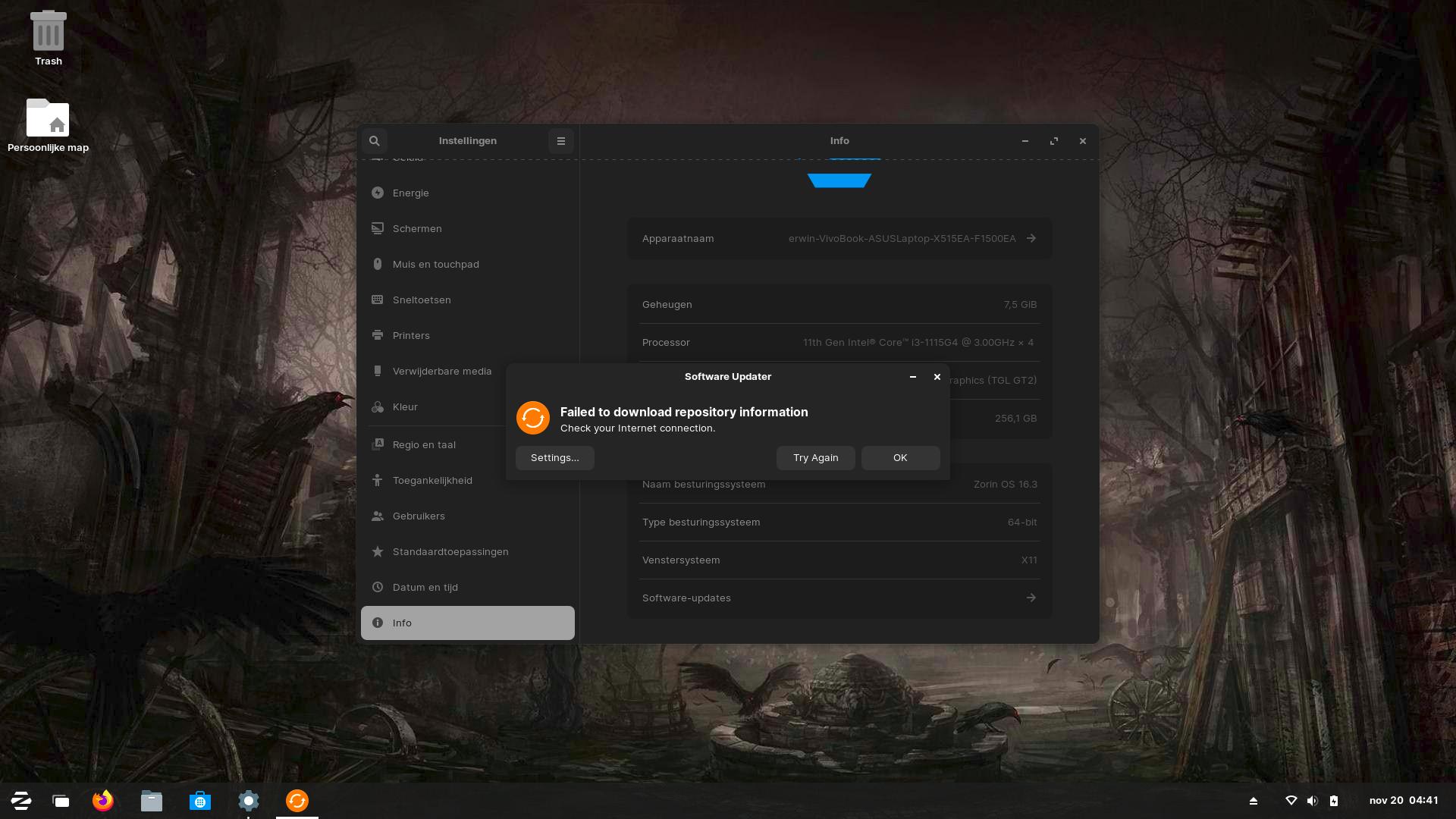

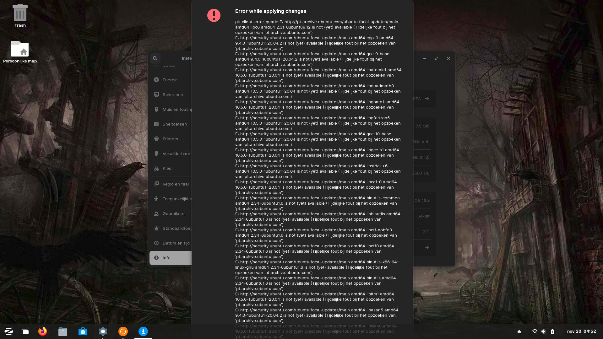

every time I open the Software-section the connection fails completely, there is no way to get updates or install any kind of software.

The software and updates-section / additional drivers-tab does show the right network adapter but says “the device is not working” and the option “Do not use the device” is selected by default. When I select the option “Using DKMS source etc.” the screen hangs.
Thank you both, I am still struggling to get a stable connection, I can connect with my phone-hotspot but it's on an off also and I can't get aravisians first command to run without errors, says it can't connect to ubuntu... etc. I need to find a way to get a secure connection, but I am out of ideas at the moment.

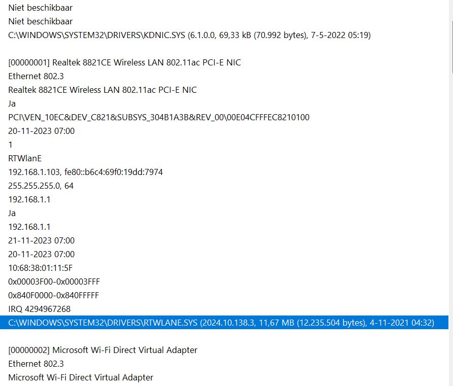

Now that I have a stable connection in Windows, can't I download the right driver-files somewhere and load it into Zorin with a USB-stick or from the external HDD (where ever I save them). Or is that not possible?
