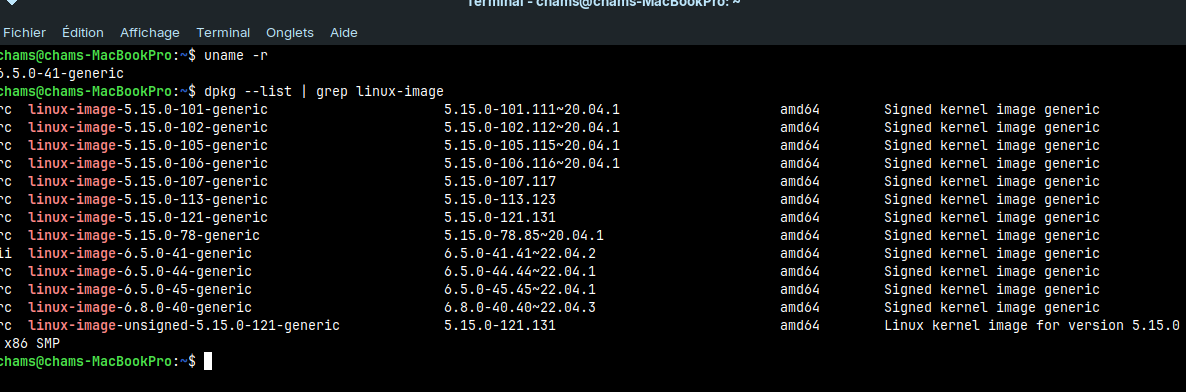

Hello ThePhantom,
thanks for your clear feedback !
In a separate thread, I am discussing on the KERNEL verison that I should install and I think I should install the 6.3 or 6.5 version because it should support the NVIDIA 340 driver that is required for my NVIDIA C79 Geeforce 9400M.
So, I have installed the new kernel 6.5 and will see if it is ok or not.
After the kernel installation and the reboot, I see:
Then, no issue with the next commands, except for this one:
sudo dpkg --purge $(dpkg -l | grep nvidia | awk '{print $2}')
I got an error because I don't how to setup the parameters...
So, I jumped to the next step:
sudo apt-get install build-essential dkms
sudo apt-get install linux-headers-$(uname -r)
and no issue.
But I got an error with the last one when I tried to install the 340 driver:
sudo apt-get install nvidia-driver-340
I think it is because the 340 driver is not in the KERNEL 6.5 but I am not sure.
I will try to redo this procedure with the 6.3 instead of the 6.5 and will let you know but I don't know where can I find the name of the kernel 6.3 version ?

Even 5.15 might not work because according to nvidia :
The Linux 340. legacy driver series is the last to support the G8x, G9x, and GT2xx GPUs, and motherboard chipsets based on them. Support for X.Org xserver version 1.20 was added to the 340. legacy driver series with version 340.107, and support for Linux kernels up to Linux 5.4 was added with version 340.108. No further releases from the 340.* series are planned.**
https://nvidia.custhelp.com/app/answers/detail/a_id/3142
