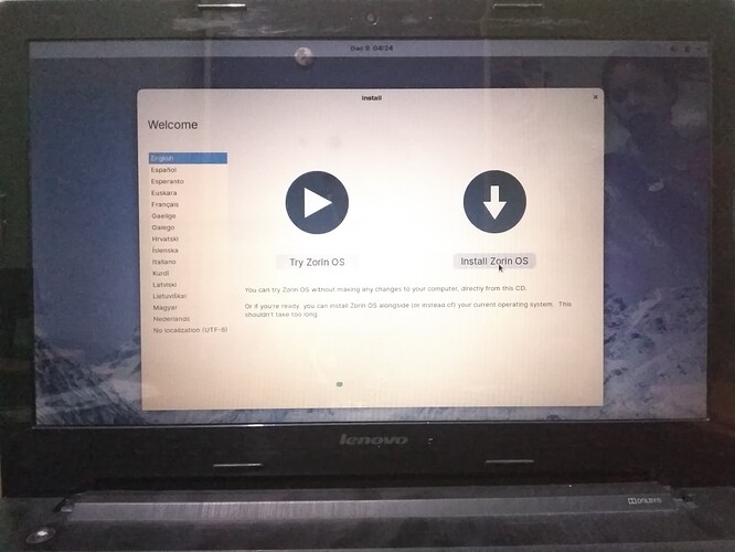

Perhaps you still have the iso file already installed on a pendrive. With this one you can boot the OS (also for installation). If not you will have to write the iso to the usb, but I guess you have done this before.
First and then reach for the file(s) you want to keep by copying them to the second usb.
When done backing up/copying, you can install the OS again. Behold, this will overwrite your previous installation and data if you choose to format and install to the SSD/HDD.

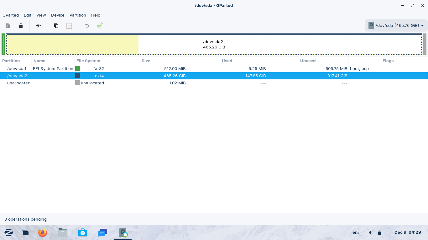

But can you boot up the Zorin iso and provide us a print screen of the drive which is present in the computer right now.
You can do this with the Gparted app.
Okay.
Screenshot of GParted
Hello sir, I am sorry to forget that I have used only 148 GB on this pc. By mistakenly I have told you about the harddisk in my another PC
No worries there my good friend. You're doing perfect.
Just as I thought you have enough space to use as a backup.
You can use gparted to create a separate partition of 200GB.
After this you can startup the file manager, so you can manage your backup data. Copy the files you want to keep to the newly created partition.
When done you can start the installation and make sure you install the system to the first partition which already has Zorin.
You will have to format this and install the system once again.
Hope I am clear enough?
