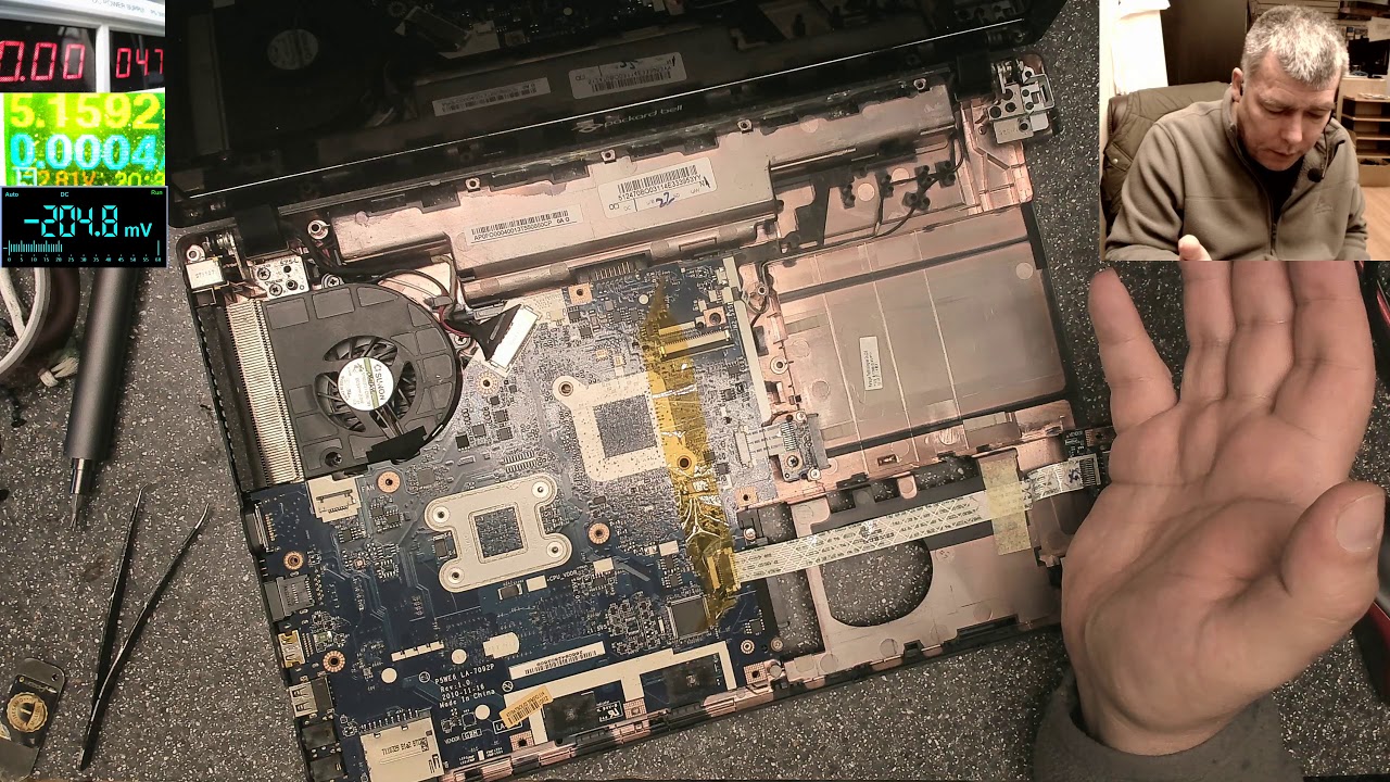

Monitor on notebook (laptop):
Many Notebooks have an outgoing port for additional monitors. You can try to connect an external monitor to your laptop, then boot and test to see if that external monitor connected t your monitor gives proper display. If it does, then this is a very strong indication that something is wrong with the built in Monitor of the notebook. You MAY be able to set up the external display as your primary monitor as a temporary display (as a "band-aid") in order to regain functionality of the computer. But this would be tricky.
You can check the ribbon connection from the graphics board inside of the notebook to the notebook monitor - ensure it is secure. If it is splitting - replace it. If it is not securely connected - reconnect the ribbon cable, then test that the signal is going through by carefully powering the notebook on prior to reassembly.
If you can find nothing wrong with the connection or cable, you can check the Backlight of the Notebook monitor.
The final option would be to replace the Notebook Monitor:
