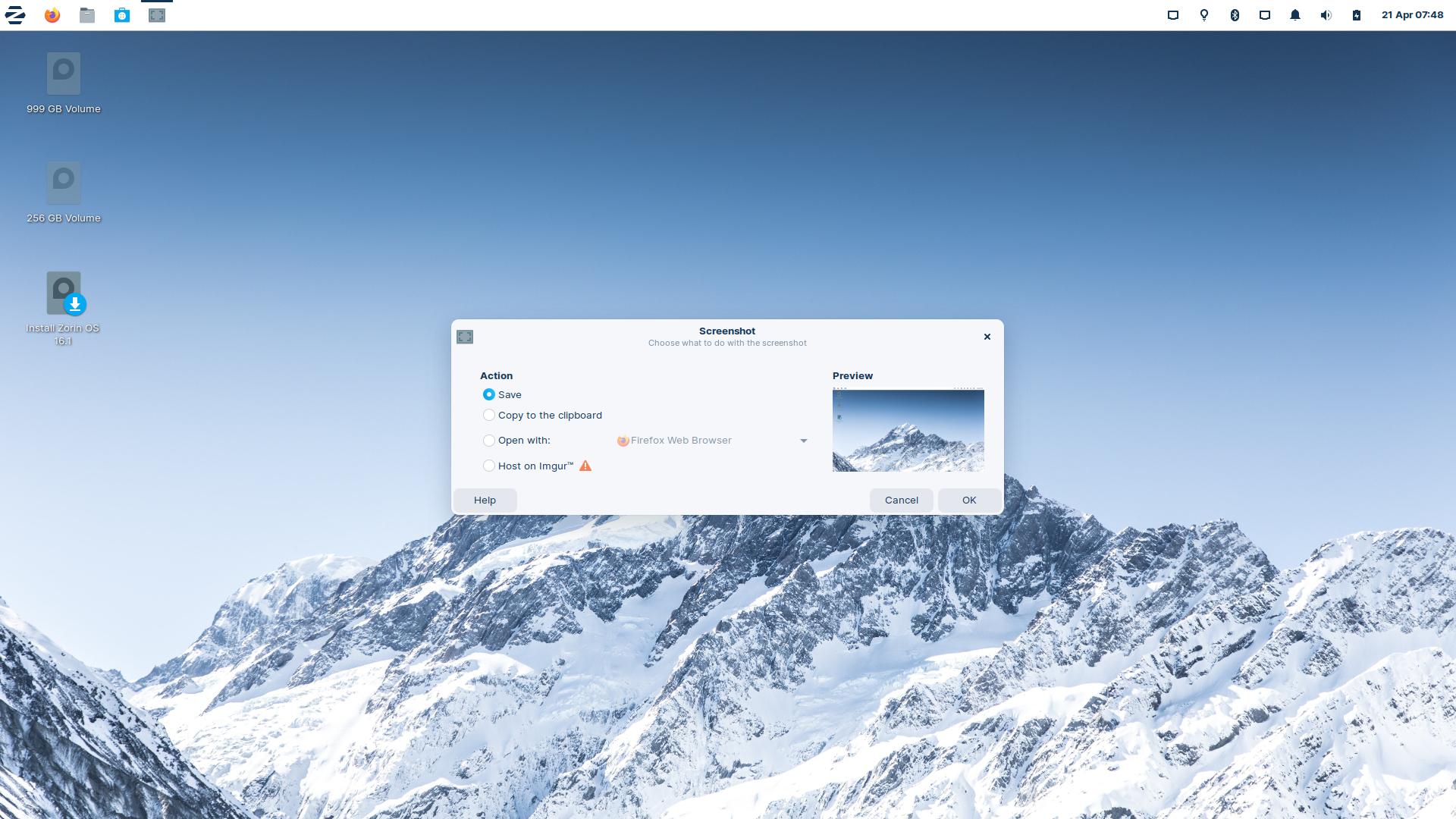

i will put screenshots of what happens when i click printscr on the keyboard
This is what happens when i press to take a screenshot on Zorin Lite.
I need to take several photos non-stop without all these annoying pop up windows get in the way . I cant take several photos with this thing . its impossible . It always opens up these pop up windows each time I take a screenshot
