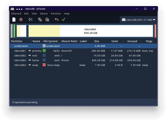

From personal experience I have found Ventoy to be good for installs. I would advise using the something else method and use Gparted to create the partitions. You could try this:
  1. Create a /boot partition formatted to FAT32 o 286.102294922 MiB (= 300 Mb (MiB = MebiBytes, Linux does not use MegaBytes)
  2. Create a Primary partition formatted to Ext4 FS of 80 Gb and label it (GB to MiB Conversion Gigabyte to Mebibyte Calculator)
  3. Create an extended partition to the right of '/'. At the END of the extended partition create a 'swap' partition = to double the amount of your physical RAM (in Mib). You don't need to specify FS as GParted does this automatically.
  4. Everything to the left of your swap area create '/home' partition formatted to Ext4 FS.

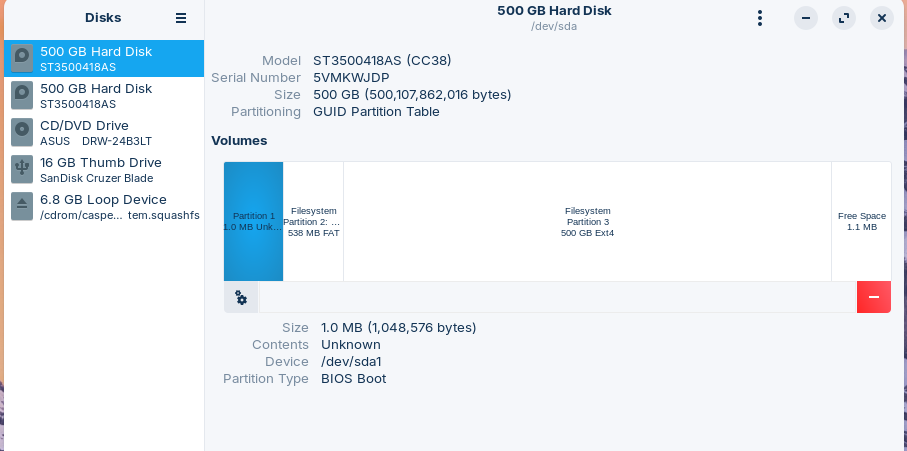

Ok, that worked. The installer booted on the machine, installed Zorin... But when I reboot, the PC hangs with just the _ cursor in the upper left corner, same as with the Rufus version. Nuts.

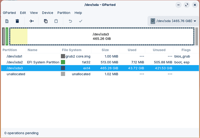

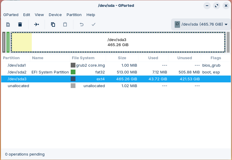

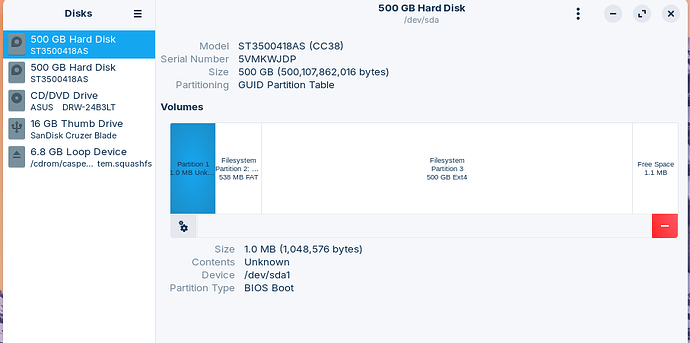

This is how the Ventoy set up the drives
What shows is Gparted
Hi, I spotted the error straight away in the GParted screenshot. sda 3 has not got the flag of '/' for the root file system - the bootloader will be looking to see where '/' is and the flag is missing. Click on the 'Edit' funcition and see if you can change the flag.
On my OS I have mount points, so I am wondering if you need to edit FSTAB?

I went into gparted. clicked the sda3 line. The edit tab on the top row only has 3 grayed out options. Right click on sda3 brings up a menu with several choices, manage flags is one. It has several options, but nothing that tells me it will put a / ... ?
Hi, GParted won't do it - it does not look at mount points, it only displays them.
You need to boot off your live media that you used to install Zorin with and edit the entry for sda3 in fstab:

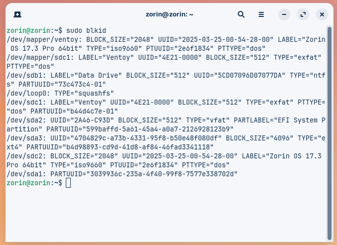

The above is what sudo blkid gave me.
I'm not sure what all that is.
The computer has 2 SATA 500GB drives.
Well the line starting "/dev/sda3" is where '/' has to be assigned to.
So
sudo mount /dev/sda3 /mnt
then
sudo nano /mnt/etc/fstab
Check to see what is in the fstab file and post back what it says.

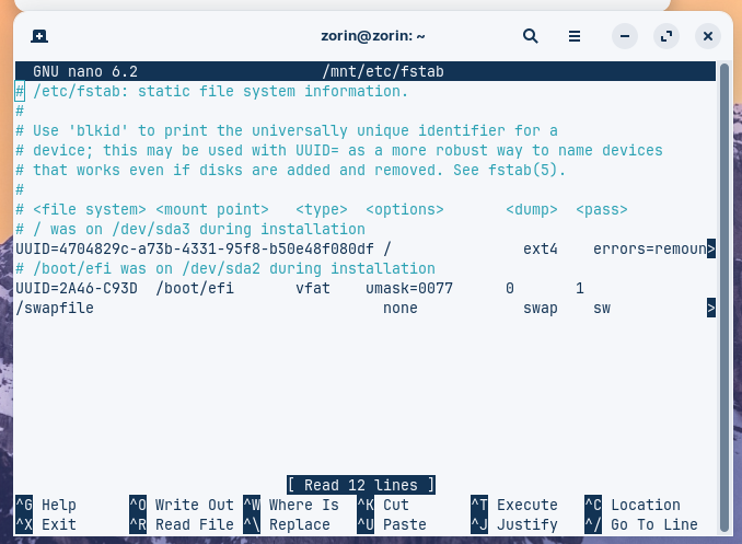

This is what came up after I did the sudo nano line
OK. So it says "errors".
You need to now follow the advice in that important note at the bottom of the previous post about ebabling rw (read-write) of that partition then run the fstab command again. Personally I would do a fresh installation.
