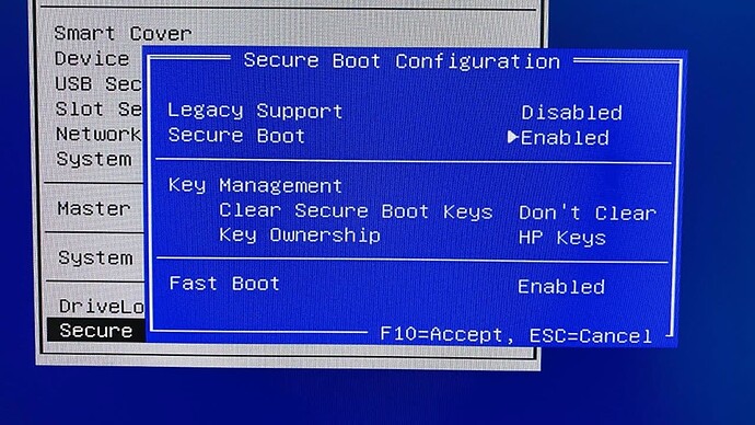

(1) Please make sure that you have secure boot disabled in your computer's BIOS.

God! What a struggle! Ventoy wouldn't install on the USB. I then found Ventoy liveCD and used that to put Ventoy on the stick. Then booting from the USB gave a warning of an unsafe device, so I then found I needed to disable Safe Boot, but found there was no option to disable it. Finally found an article saying how to disable Safe Boot on Asus. Three frustrating hours later, I've got it working.
