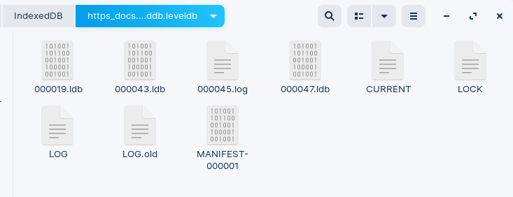

I followed the uninstall instructions, but it is still there.
I cant find the repo there.
I have found this folder, should I delete it? It is the only containing the name of the repo.
Bildschirmfoto vom 2024-01-14 15-35-11
I have found a Help Article at askubuntu. Maybe that could help you: Here.
I tryed but I only get this error message
Bildschirmfoto vom 2024-01-14 17-58-14
das Entfernen von ... ist nicht möglich: Datei oder Verzeichnis nicht gefunden =
removing ... is not possible: file or directory not found
I found a Solution: I deleted this folder:
now the software updater works correctly again.
Thanks to everyone for there help.
