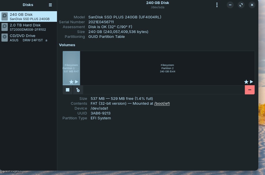

Don't know if this helps. I'm trying to copy stuff from this drive (SSD, boot) to the second one (2 Tb HD)
What I'm trying to do and why. I have a 2 Tb hard drive sitting there not getting used, so thought I'd try to copy stuff to it as a sort of backup, rather than have it go to waste.
But am happy for other ideas how to use it.
I've no idea if how I've formatted and partitioned it is correct - it used to have Linux bits and Windows bits

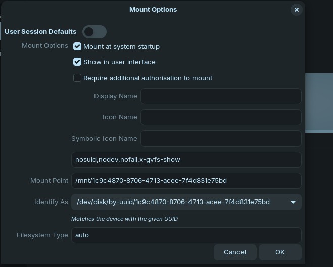

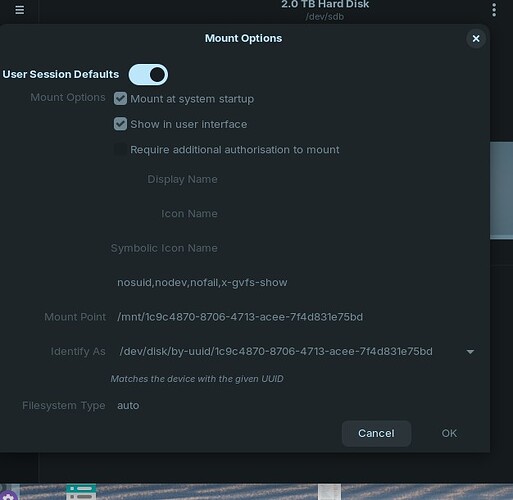

Did you modify anything else inside of Disks to make the mount automatically, perhaps? If you select the drive and then click on the wheel icon there should be an option called "Mount options" or something similar. Can you show that?
