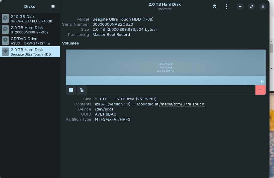

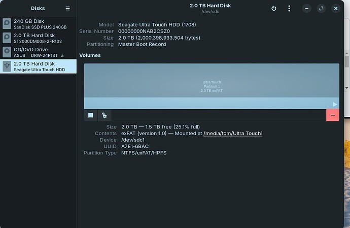

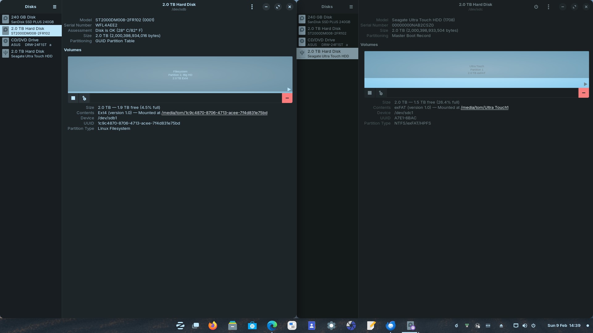

Does this comparison of the internal and external hard drives help?
Ah, I see. Then, what I think happened is simply that this folder was created once by the system, as root. All you have to do is what was advised earlier by @swarfendor437 and change the ownership of that directory:

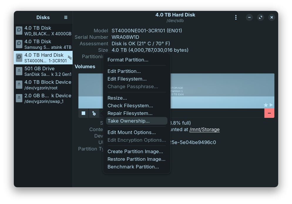

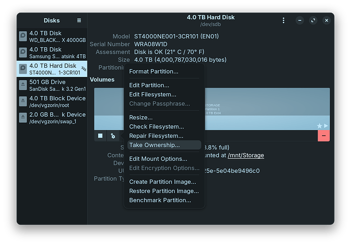

Apologies if I missed this (it's a long thread and I came to it late), but I'm mentioning it in case someone in the future has the same issue and is command line averse. If you need to take wholesale ownership of a partition, you can do so in Disks by clicking the settings icon on a partition and choosing "Take Ownership..."
I know Tombar is fond of the CLI, but this is another option to reinforce the claims we tend to make that people don't have to use the terminal.
