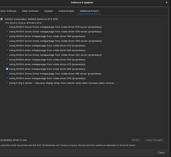

checking what video driver is currently running, now it seems to have been set to the 565 for the first time.

@Ponce-De-Leon ok! some progress,
i checked software center and at the very bottom i did have quite a few different codecs installed, and went ahead and ran $ sudo apt-get install ubuntu-restricted-extras
rebooted the computer and success !!
i noticed immediately the difference in performance and behaviour,
in fact, applications/games are performing even better than before,
so it seems that i was missing key codecs and the install of "ubuntu-restrictred extras" package really did do the trick !
or perhaps in addition to the driver changing to 565 as well with the pairing of the installation of restricted extras all did the trick ?
wow im very relieved and thank you all again for the responses !
you just bought me some more time until i finally cave and buy a new system
Thank you Thank you Thank you ! :beers:
